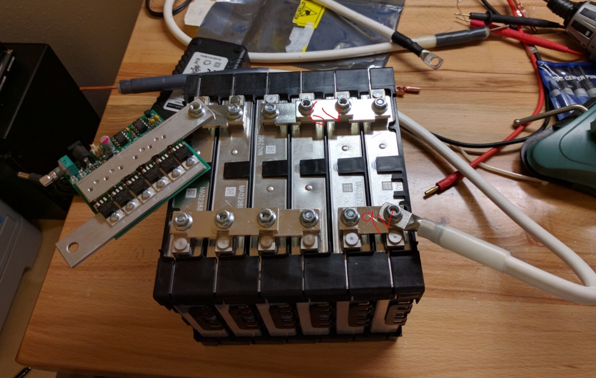

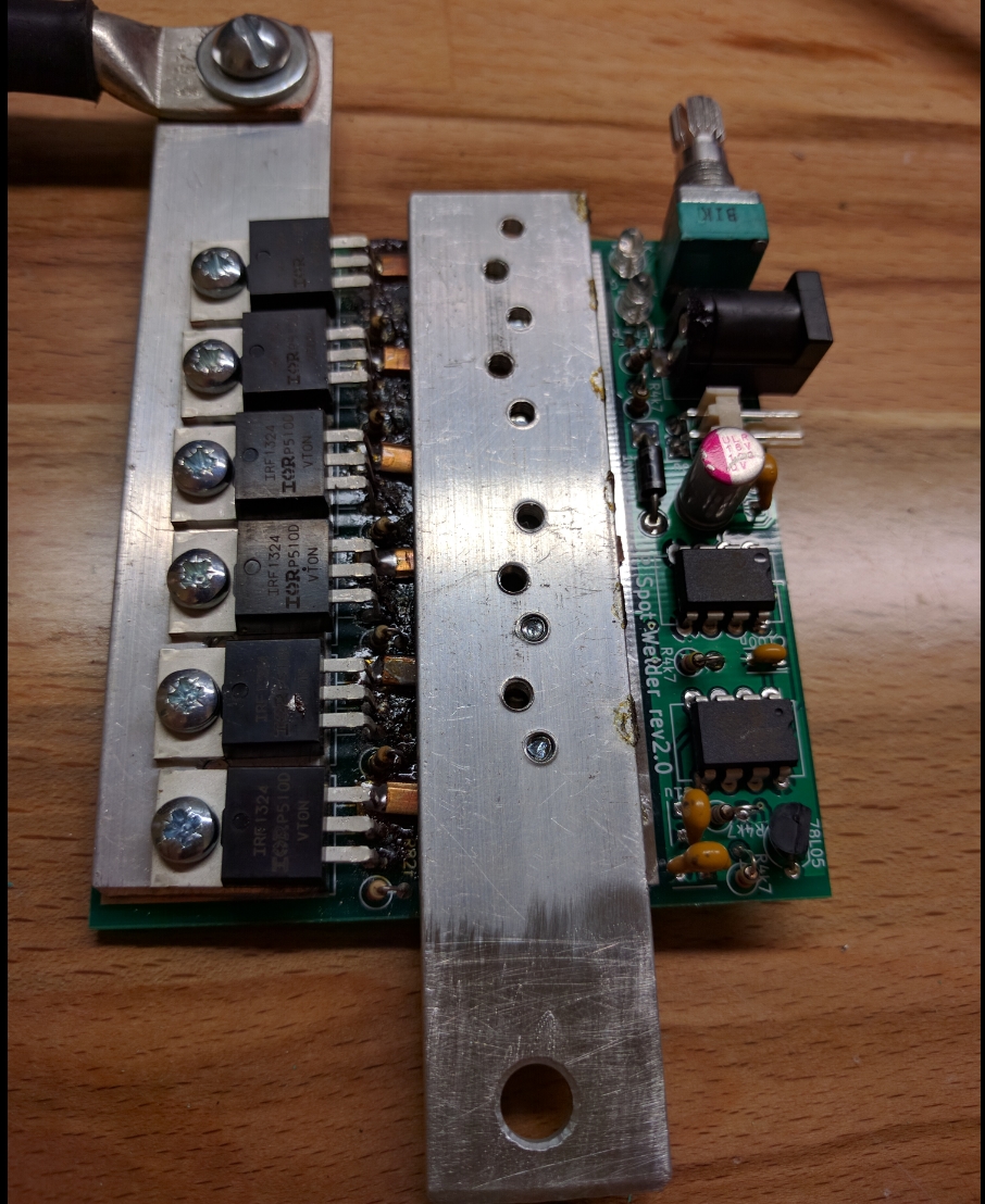

I setup my welder for the first time and ran into some trouble. I'm not an electronics whiz, so I could really use some help troubleshooting.
I got the welder connected directly to the negative lead of a 12V 490A car battery holding a charge at 12.9V. I've tried 2 power supplies, the first a 12V 750mA output, then the second a 15V 3.0A output. In both cases, the red LED illuminates; however, when I put the welder leads to the test battery/nickel strip and hit the footswitch, nothing happens. Well not exactly nothing, I hear a faint but audible click from the welder board in addition the the normal click from the foot pedal which doesn't occur when the welder leads are not making contact with a conductive surface. I've tried adjusting the potentiometer through the whole range to no affect. That's about it, I'm stumped as to what to do, any advice? I hope I'm just forgetting something dumb here.
Attaching pictures of my setup for reference:

Is that a steel link of some kind between the aluminum bar and the neg. battery terminal? It would seem that something is limiting curent and I would suspect that extra connection. See if you can find a way to attach directly to the battery and make sure every thing is tight.
@Hwy89
Unfortunately it's not a connection problem. I had an extra 12V battery I hooked the welder directly to the terminals (see pic) with the same result. No green led, no weld. Any ideas? Definitely sucks to be at the end of a year long project without a path forward.

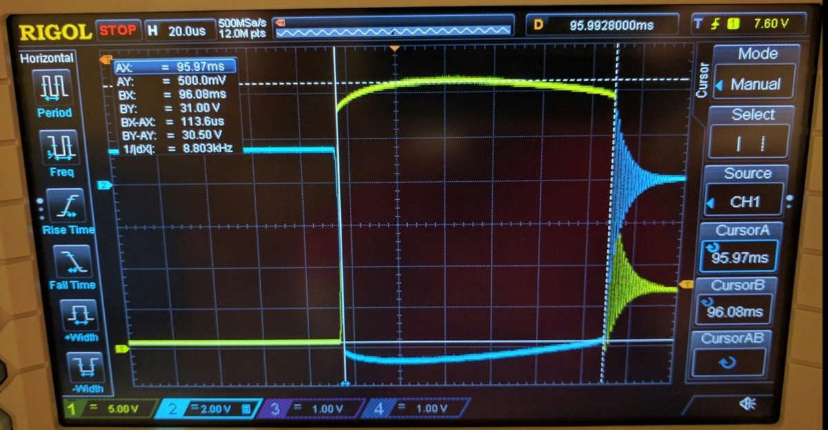

I am preparing to offer some weld kits so going to do some testing of weld current with 2p and 3p of my batteries with 3s and 2s configuration.
Here is 2p2s at 6.4 volts:
Yellow is Source Drain voltage
Blue is voltage across 27 inches of 4awg welding lead.
No diode.
This is with welding leads shorted to eachother:
Here is Mosfet turn off:
Avalanche lasts for 113 microseconds. (hits a peak of 31V, fets are 24V rated!!!)
Note that the single welding lead (27 inches long) generates a peak negative voltage of 8.5V more then the whole battery in a single welding lead
Measured current was 2,593 amps (1.45V voltage drop across 27" of 4awg wire)
Current rise time at mosfet turn on is about 1 millisecond from 0 to 2,500 amps.
I am using about a total of 59" of welding leads, 4awg.
When my diodes come in (gave to buddy) I will compare the avalanche before after diode, and take measurments at 3s with 9 volts. :))

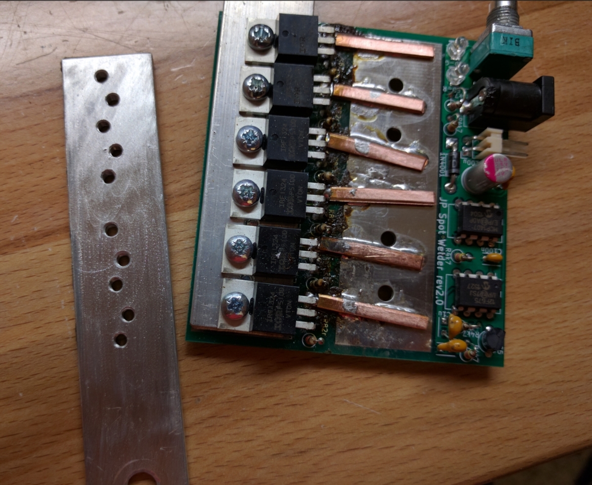

Here is how I repaired mine blown traces:
soldered copper straight from pins into bus bar area
Cleaned up the pins
Re attach with screws, now the aluminum clamps straight to the copper.
