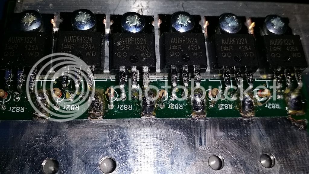

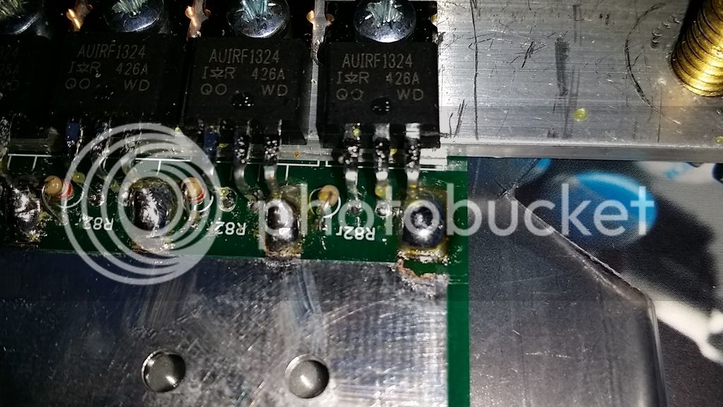

Do you think it is possible he burnt the trace under the aluminum bar, like some of us has?
I believe he needs to unscrew the aluminum bar and check the traces, very good chance he burnt those out welding and needs to bridge the connection to the fets. This is what happened to me as you can see in the picture. Burnt all the traces.

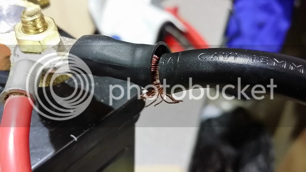

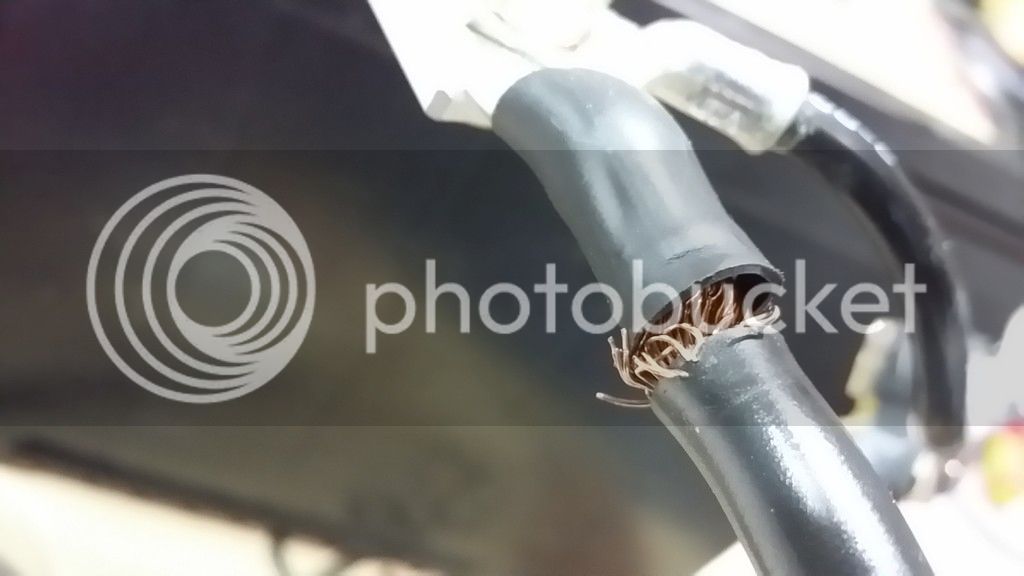

Want to also comment that the probe wires will break where they attach to the battery and welder.
I had to move my probes a lot when welding my pack and the copper strands started to break, I believe it is worse then what you can see in the picture. I can easily see mine under the shrink tube. Both wires are breaking as shown in the pictures.
It is an easy fix, I'll have to cut it and recrimp it but something to take note.
Anyway to stress relieve this area?
Replacing the cables with more flexible ones might help also. I've seen some super flexible welding cable that has a higher strand count.

Your crimping technique will effect the stress relive on the wire. I try no to crip the while lug tight. The wire side of the lug has a radius to give stress relief when the wire is moved around.
