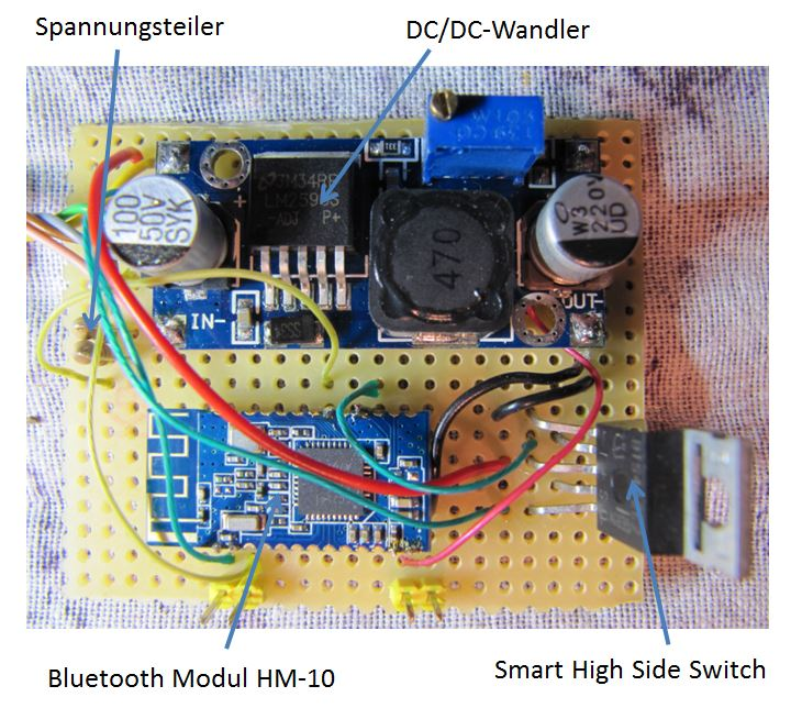

I think you can go even further by making your app to also be able to turn on and off the TSDZ2 power. As I shared before, Stancecoke did a Bluetooth module that can also turn on and off TSDZ2 power: https://opensourceebikefirmware.bitbucket.io/development/Motor_controllers--BMSBattery_S_series--Bluetooh--DIY_Bluetooth_module.htmlfeketehegyi said:It's written that the HC05 module works on 3.3v TTL. But the Motor controller works on 5v TTL, so the level shifter is needed. Also a 5v and a 3.3v power source is needed therefore I plan to buy such 2 regulators.
They cost together approximately 5EUR or 5.8USD. Then a switch max 1EUR, and a poor man's cable connector for 0EUR.
For this latter I assume can the extension cable used as well: https://www.eco-ebike.com/collectio...oducts/extension-cable-for-tsdz2-speed-sensor We'd only need the male part of this. Unfortunately this kind of cable connector is rarity.
Then pack all those things together and attach to the frame and plug into the LCD cable connector - and use my android app as LCD display via bluetooth. So, this's my next plan to try out.
