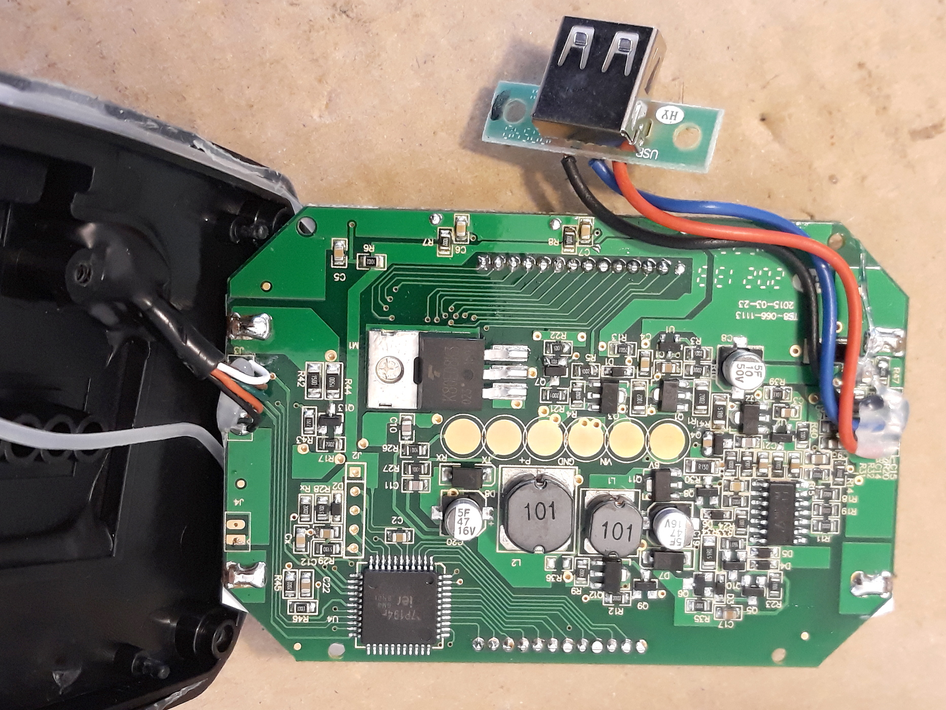

For those of us still using the VLDC5 display , which has a USB port.. (Reported to be a 5v Phone charger only ??) ...is it possible we could simply use a suitable USB Bluetooth "dongle" and fix some jumper links from the display board to pick up the RX & TX connections to the USB port ?
This would avoid the 5v and 3.3v requirements , and retain the original controls (on off etc),
Probably totally impossible ????
You shoild read my notes about that display, I have pictures of the inside, etc.
casainho said:
Thanks C'....are they in this thread somewhere ?

casainho said:
Casainho,..Thanks for the tip, and the photos etc..
.. did you figure out the pin out links to the USB port ?...i could not find them.
Does any of those details change with the 8 wire connector cable on recent drives ?
Black ..Ground ?
Blue ...?.. 5v ? maybe
Orange... ? Rx maybe ??
