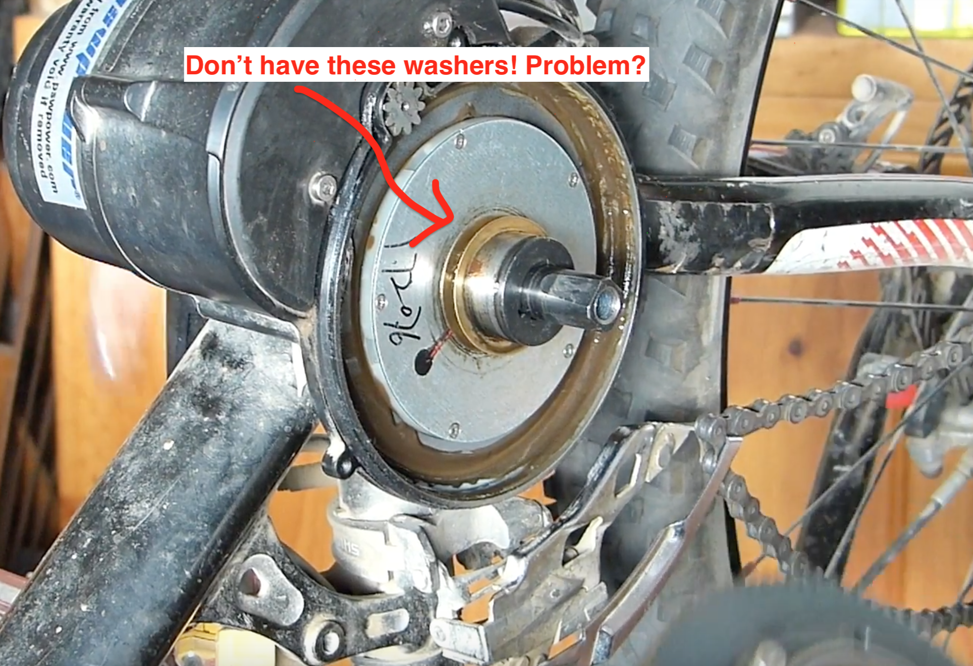

I'd be curious about your input on lateral play of the chain ring spider on the axel: https://www.youtube.com/watch?v=I7ueCrxFKOU
You can feel the chainline changing under torque. Is this something worth repairing?

Try to tighten all the screws of the chain ring spider, including those that screw the motor. That slack is not normal

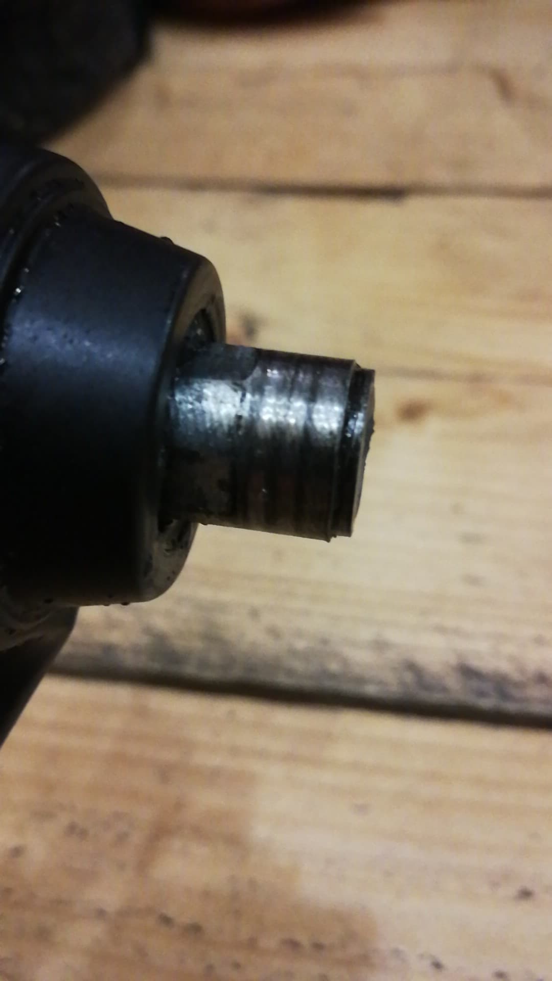

So my 120mm Fatbike Axel just broke for the 2nd time after 1250km of riding in total. :shock:
I bought this axel from Future-Bike (like the 1st one) and I'm wondering how it is possible it breaks... This time while standing on the peddle while cruising my city, nothing too fancy. Any suggestions or better options to replace?
I could move the Axel left to right because the 'locking ring' was maybe broken or missing. Could this be the reason it brakes so easy?

Okay, I tried tightening the 5 bolts closest to the drive-side crank that hold the spider to the main drive gear. I gave them 5nm, didn't want to give more for fear of stripping. The spider was still loose.
I then removed the main drive gear and noticed that I lack the brass spacers behind the sprag clutch (described here: https://www.youtube.com/watch?v=u-SY0rGMEMo). The author appears to have an older version of the motor, as my main drive gears are helical. Did they remove the spacers in newer motors? Otherwise, perhaps the fit of the clutch on the axle is bad from the factory?

More likely a materials problem or perhaps in the post machining hardening process since future-bike.it manufactures the axle themselves. You really do need the lockring though. That could have contributed or caused other bad things to happen if this hadn't happened first.
