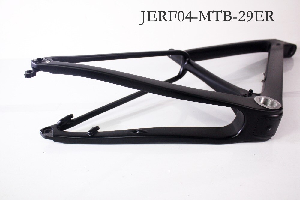

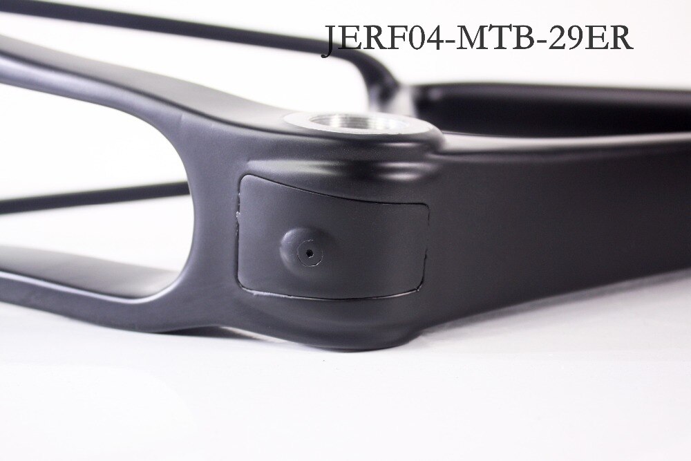

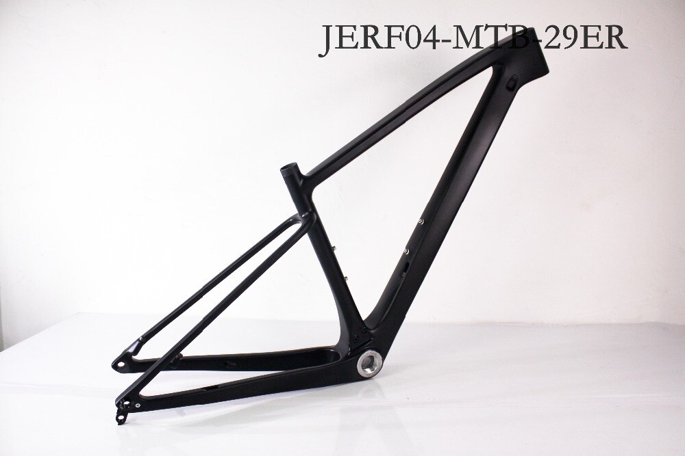

Hi everyone ,
Do you think the TSDZ2 will fit on this frame bike ?
BSA , 73mm wider
Hi,
I'm afraid not.
The bottom bracket must be a protruding can to allow the chain side to rest on.
With such frame the metal housing will clash before the BB gets in contact --> very dangerous structurally.
You may need spacers to clear the clash but this increases the chain line offset.
Not definitely the best frame for the motor..
Thanks for the advice !
It's so hard to find a compatible carbon frame ...
I have the impression only frame bike in aluminiun older than 5 years fits ok with the tongsheng
And do you know an another motor with torque sensor ok with this one?
Does someone have a tsdz2 to sell? although it's spoiled! I just need the casing!
I am from Spain!...

Yes , i already mount this motor on a aluminium bike frame ...
But i have a new project , mount a eletrical bike with torque sensor motor on carbon frame
I prefer carbon frame because for me the feeling is better , it's more lighter , more beautiful and give more power and reactivity
And it's also easy to find good recent carbon frame for low cost.

It is a rare carbon frame that will take a mid-drive conversion motor. Especially if you need a bb adapter first. The bb shell is just too thick. Bafang motors have 12mm clearance between the bb spindle tube and the motor. I am not sure exactly what the TSDZ2 is but I think it is a little less. I have seen a few carbon frames with a threaded bottom bracket that do work, but they are the exception.
You right , the first problem is to find a bb shell not too thick,
