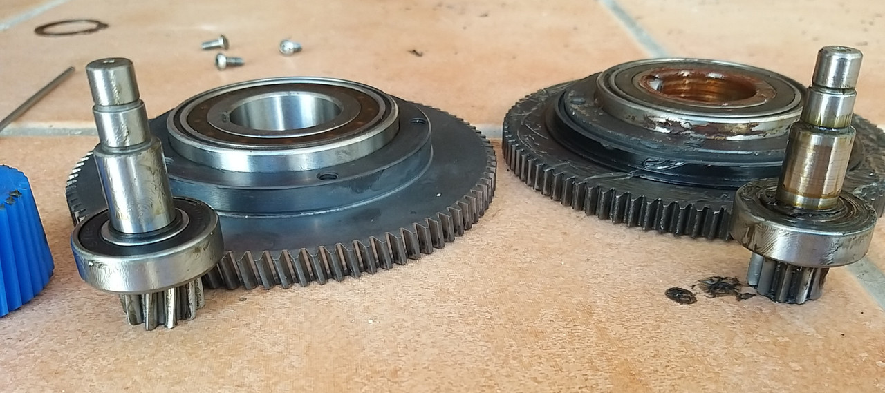

Recently I upgraded my wifi ebike TSDZ2 to the most recent version by changing the main gear and pinion to be helical - the main advantage is to have a more silent TSDZ2:
Interesting. What sort of cost for the parts and is it worth it?
mctubster said:
Go and see by yourself the prices. You can find on Aliexpress that parts.
I've just done the same and YES it's worth it :)
I went from a low growling dog-machine to an electrical sounding bicycle engine.
If I bought my TSDZ2 recently (within the last 2 months), it should already have the helical gear, is that correct?
CatfishMan said:
I don't know. That motor is at least 1 year old.

Great thanks for confirming. Have ordered the two parts. Time for my first teardown almost 2000kms
In case of sprag clutch replacement I might consider a switching from straight to helical gears: in this case it is necessary to buy both big gear and reduction gear, correct? Is the second one available on pswpower?
thineight said:
In case of spray clutch replacement I might consider a switching from straight to helical gears: in this case it is necessary to buy both big gear and reduction gear, correct? Is the second one available on pswpower?
Yes, the little axle/gear mesh against the big sprag clutch gear. Can't find it on pswpower, but it's available at aliexpress, https://www.aliexpress.com/item/33011901273.html
The large gear in particular is a real heavy beast, sometime ago I saw I think on the Italian forum pictures of a gear that had been lightened. Anybody have these pictures or any suggestion on lightening the gear ?
Thanks, did anybody tested side by side the two gears and confirm that the helicoidal is quieter?
thineight said:
I did, mine ebike always had helical and my wife always had no helical -- I could clearly listen the difference, no helical does more noise and is then less "elegant" when we are riding near the other no ebike MTB riders. Silence is important when we are on the quiet mountains. No one would ever accept to ride near a bicycle with a gas motor (although there are also chinese KITs of gas motors for bicycles), doing high noise and fumes, electric has a very good advantage here :)
