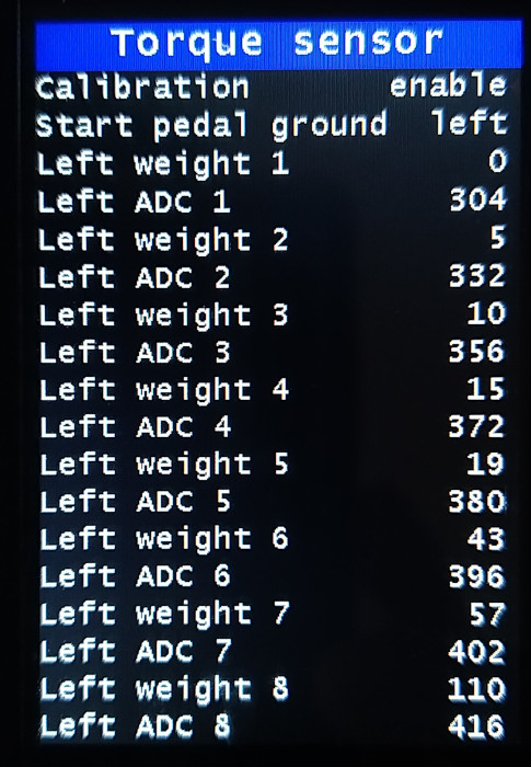

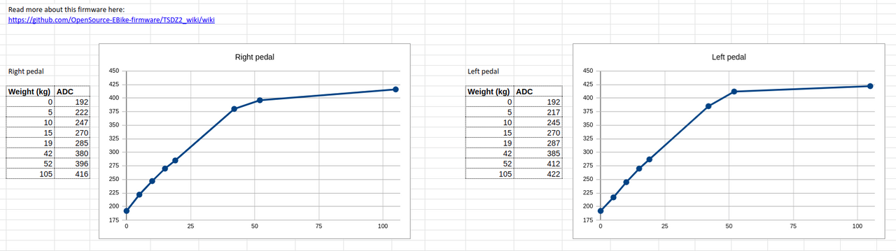

Improve your TSDZ2 torque sensor
Here is the new release of our OpenSource firmware that improves the TSDZ2 torque sensor: https://github.com/OpenSource-EBike-firmware/Color_LCD/releases/tag/850C_v0.6.1
(sorry, 850C only as currently we have an issue with the SW102 code)
Here is my wife bicycle and my bicycle the torque sensors measurements - the torque sensor of my wife TSDZ2 is way better than my torque sensor, here the comparison:
My TSDZ2 torque sensor:
My wife TSDZ2 torque sensor:
My notes:
1. One torque sensor is kind of linear only up to 15 kgs while other up to 45 kgs. The rate/sensitivity are the same for both on this "linear" zone but clearly mine lacks resolution because this zone is very short. I can do peaks of 40 or 60 kgs on my pedals without taking my but from the saddle.
2. One torque sensor seems to measure the similar values for both left and right pedals while the other does not (the left pedal has lower sensitivity).
3. The one that is worst on 1. is also worst on 2. So, clearly there are torque sensors that are worst than the others.
How to calibrate:
- go to Technical configuration menu to see torque sensor ADC value in real time
- use weights, your own known weight, weight from other members of your family or friends (mainly others with different value), put them on each pedal only (the pedal must be parallel to the ground)
- take note of each weight value and ADC value
- choose 8 points, first one with 0 weight value and last one with your weight
- use a copy of this calc sheet as seen on the next image. Draw a graph and choose the other 6 points near the knee zone as seen on the graph and not on flat zones. You can extrapolate some points if you don´t have the weights, follow the curve on the graph but try to validate with real measurements:
- go to Torque sensor configuration menu and input the data of each point: weight and ADC value
Torque sensor calibration table:
Seeing and validating the pedal side as also the weight measured on the pedals:
How to use:
- everyime you startup the system, the pedals need to be vertical pointing to ground. You can select on Configurations to be left or right pedal to point to ground at startup, based on your preferences. This is needed to the system can know in which pedal are you doing the force with your legs, since the weight is measured differently on each pedal due to the torque sensor.
