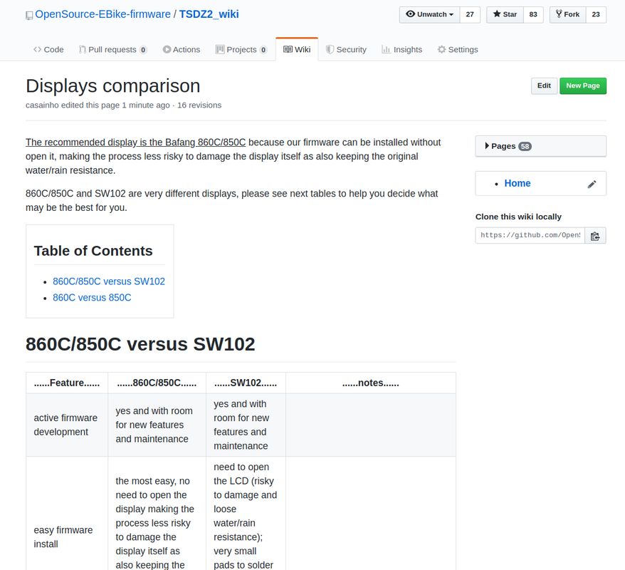

What is the advantage of the 860C over the 850C?
Brlowe said:
casainho said:
Thanks to the shops https://www.electrifybike.com/ and https://www.eco-ebike.com/ that are being help in various ways (and then stimulating) to get the 860C display working on our OpenSource firmware, I hope to get it work in next 2 weeks. For now, I created a wiki page with pictures of the board and some technical details:
https://github.com/OpenSource-EBike-firmware/Color_LCD/wiki/Bafang-color-LCD-860C
I just wrote a comparison table, see here: https://github.com/OpenSource-EBike-firmware/TSDZ2_wiki/wiki/Displays-comparison
