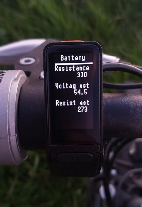

New feature: battery pack resistance
One important technical characteristic of the batteries is not only the capacity in watt hours (WH) but also his internal resistance - the lower, the better.
The next firmware version will automatically calculate for you this value, you just need to pedal / run the motor for some seconds at a high battery current value like 10 amps. Then, you need to insert this value on the battery resistance configuration field - you should maybe increase a bit the value to be conservative.
Q: Why is it important and how it is used by the firmware?
A: It is used to calculate with a very good accuracy the state of charge of the battery (SOC) as also in future to calculate the energy watt hours per kilometer (will be shown on a graph on 860C/850C display) and estimate the available range in kms.
Here an example of calculation of power loss inside the battery due to his internal resistance:
Assuming the TSDZ2 is pulling 16 amps from the battery, and that my battery of 350 Wh (watt / hour) has an internal resistance of 275 milliohms, the power loss inside the battery is: P = R * I * I = 0.275 * 16 * 16 = 70.4 watts. As we can see, this power loss is equal to 20% of my battery capacity!!
I know there are battery cells on the market with half of the resistance, so, by using them I would have an extra 10% of my battery capacity on the previous usage example.
Real example of my battery and measure on SW102 - Resistance est is the value automatically calculate and Resistance the value I decided to configure:
Note that I validated this automatic measurement with 2 different battery packs, both with the same cells but one is a 14S2P and other 14S3P. The 275 milliohms was measured on the 14S2P and 195 milliohms on the 14S3P, which for me makes sense comparing the theoretical values.

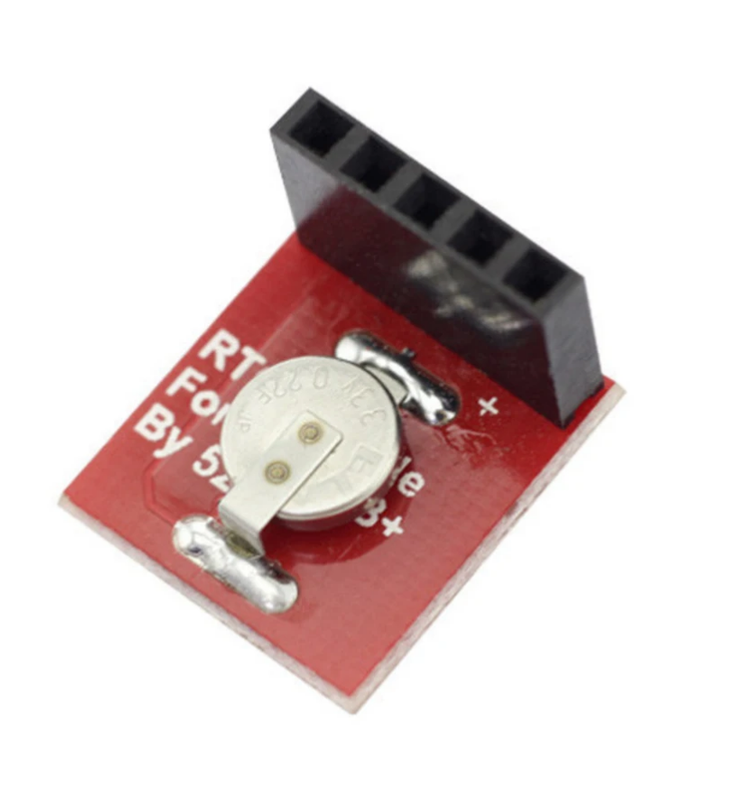

Huguenot said:
First, the clock looses time. This seem to be a mfg flaw and perhaps the display should be replaced? Not critical but annoying. I have a Luna 750c on another bike which does the same thing. Is the 860 display any better in this regard?
Today I tested a new 860C display and after about 36h the time drifted. On the other side, the one installed on my bicycle is keeping the time correct but I am using it every day.
Since there are supercapacitors on this type of RTC circuits, I now assume it is an supercapacitor and not a battery and so that is the reason why it holds correctly the time only for about one day and half.
Here an example of RTC circuit with a supercapacitor: https://wiki.52pi.com/index.php/Raspberry_Pi_Super_Capacitor_RTC(English)
casainho said:
Could the supercapcitor be replaced by a coin cell battery that motherboards use for that function?

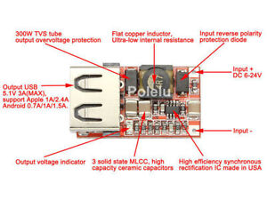

I have the 6v light cable coming from the dual connector speed sensor, and I'm only using one if the two wires for a basic front light. I'm not putting a rear light on this build, so was thinking about using the other end to make a USB output for charging a phone or something. I'll use a switch so only the light or USB is working at a time, but does anyone know if I can just connect a USB terminal to those 6v wires (I know USB power generally is 5v) or do I need a voltage regulator of some sort to safely charge electronics?
I know the amperage is also quite small so this would only be a backup solution, usually I won't need it.
Apparently this can cause issues. To be safe, I soldered a simple DC-DC 6-24V to 5V buck converter onto one of the 6V lines (in my case to charge a small LoRa GPS tracker). They are fairly cheap and tiny and already feature a USB-output. It charged - albeit rather slowly. I later removed it because I wanted minimal outside wiring and it solved a problem that wasn't really there.
One similar to this:
