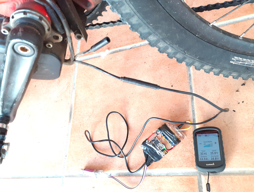

Finally I have the TSDZ2 wireless board working!! (using the EBike wireless standard)
I did a minimalist very first version that only changes the assist level - on the wireless firmware I setup the default settings for my ebike, like the wheel size, assist level factors, etc. Once I turn on the system, it is ready to work and I just need to change the assist level on the GPS display, using the touch screen or the wireless remote.
Next step is to start working on the Android app so it will be possible to change the settings with it.
Any suggestions for the Android app? - maybe I should fork the TSDZ2-ESP32 Android app??: https://github.com/TSDZ2-ESP32/TSDZ2-ESP32-Main
Here a picture of the wireless board connected to the TSDZ2 LCD connector:
