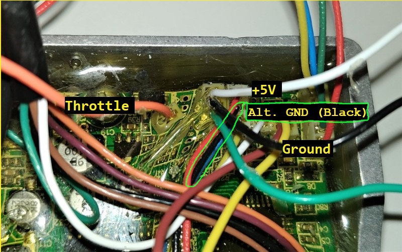

I found that 1.1.1/1.1.0 has the powerboost setting inverted. Setting it to disabled enables it, and enabled disables it. So if you have no assist when starting, try disabling startup boost to enable it. That did it for me.
So I tried v1.0.0 and v0.6.5, always the same issue: enabling temp sensor disables pedal or walk assist, disabling the temp sensor restores it. If I set temperature to throttle instead, it does read a value and accelerates.
I guess I wired it wrong? I'm rather discouraged at that point because I can't see what's wrong. This is how I wired it, using the alternate GND as my controller didn't have a wire in the marked GND on the picture:
Did I get that wrong?

Maybe try another gnd? There's a ground on both the speed sensor and display controller cable - try that instead of the battery gnd which i think you're using (edit - correction looks like you're using the black from the pas sensor). Preferably the display gnd as that's the usual setup.
I know it shouldn't make a difference if all gnds are tied together... but it might!

The room temp is around 23 degrees, but the sensor reads 42C. It's still below the 75/85 limit though but the reading doesn't match the temperature.
None of it makes any sense. I had a look again, and I'm hooked up for GND onto the display's GND. 5V and throttle as per the wiki picture.
When I unhook the temp sensor from the motor and measure it with an external 5V and a multimeter, it reads 239mV which is pretty much the room temp (23C)
But when the display reads it (on 0.6.5), it shows 40 something degrees. Why?? I think it read it correctly on 1.1.0, I remember looking into the technical menu and seeing around 200mV.

The throttle works well (with the temp sensor physically disconnected.
Because of that and the fact that 850C + 1.1.{0,1} + temp sensor works well for everyone else but for me (also tested on 0.6.5), it HAD to be a bad connection somewhere and not a software bug.
Luckily, I had put the temp sensor on a connector so I unhooked it, connected it to external 5V and GND, and checked the Vout again: nominal, shows 250mV for 25C room.
Then I hooked 5V and GND back onto the motor and measured Vout, it was wonky. I checked voltage between 5V and GND, it was also weird. Then I checked GND at the temp sensor connection and at the end of the display cable where the actual display connects, and I didn't have good continuity.
So the culprit was a bad GND wire splice (it is a major PITA to do a 3 way splice with so little space). I redid it, and now everything works well.
Thanks everyone for all the help, turns out it was just a bad solder job on my part!
