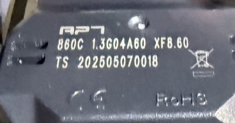

I have bought few weeks ago 8 with 860C and based on tutorials started from firmware update to 860C. I've prepared new cable for new display plug - before update checked power supply - was ok. After proper update process display not turns on. Tried with 860C_V13-v20.1C.5-bootloader and then with V20, V12 - no positive result. I attach photo of my 860C version. What do You guys suggest to do now?
Have you checked that is not a UART display with the supplier?
Not, i have thinked all works on the same rule, not found info about other possibilities
edit:
I see - there may be a problem with 860C hardware - other for bafang other for tszd. I bought it as a kit with tszd8 from pswpower - that's display for tszd probably.
Is there any solution now or display to trash?
edit:
You probably would get better feedback if you posted in the OSF thread, but I believe the display needs to be flashed with the mbrusa firmware before flashing the controller.
I assume you have been here TSDZ8 OSF (open source firmware) I looked on the pswpower are your sure the 860C from there is the correct one as with the TSDZ8 they seem to showing the 850C, message pswpower, but the circular connector is UART and the triangular connector is CAN. Recheck your programing method and cables, I did have for example my TX and RX wires transposed, did the programing software show the data being uploaded onto the display.
I've attached a photo of my display earlier – it's an 860C. The cables, FTDI, and method seem to be fine – as I can flash the original firmware and the original Bafang firmware without any issues. It's just that the 860C doesn't work with the OSF flashed.

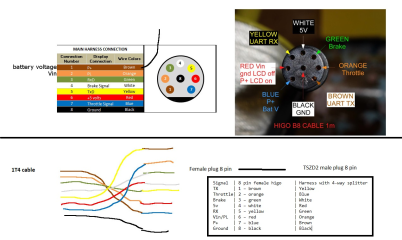

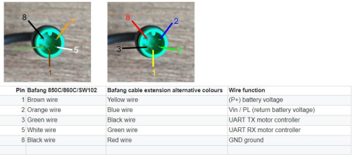

female-female 8 pin adapter cable for the intelligent 810s display
Did you find such an adapter? And no cable modifications are needed?
( Wire 860C 850C to TSDZ2 )

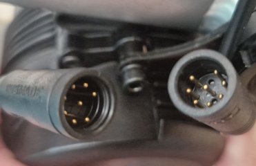

Because I didn't pay attention and during assembly I see that TDZ8 (with VLCD5(it was the cheapest)) is coming with "male" just like from SW102... (
I think to cut female from VLCD5 or from old TSDZ2B and try to solder to sw102 wire...
But I don't know if it will be enough to solder according to the location, or could something be different (for example, "ground" and "5b" mixed up, etc.)?
Do all 8 pin cables have the same pinout?

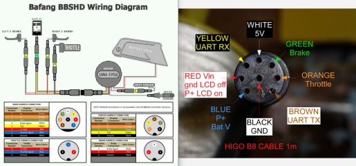

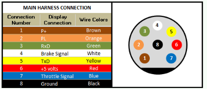

Colleges, is the 8pin pinout of the TSDZ8 (male) is the same as that of the TSDZ2B (female)?
I have this on my SW102 (and ekd01, which worked with TSDZ2B before)
UPD.:
From what I've measured myself, to connect SW102 (after TSDZ8) to TSDZ8, you need something like this:
And perhaps, in the diagram above, the RX <- ->TX sometimes are mixed up.. 0_o.. or
P.S.
To clarify, my previous TSDZ2B (8pin-female) was purchased with EKD01 (and later SW102 was installed without any cable changes) — it was a Bafang pinout?
as far as I understand correctly... now I have purchased TSDZ8 (8pin-male) with VLCD5, and it is already a Tongshen pinout...?
Perhaps someone has a transition diagram from vlcd5. -> sw102/ekd01? will be appreciate

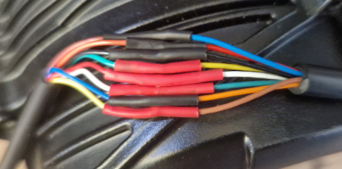

astronaut, am I answering the your question here? TSDZ2B 860C display confusion
yes, looks like it...
I just was curious about to make DYI wire
I soldered everything and checked it many times with a tester - everything is according to the schematic
Then flashed OSF_TSDZ8_860C_KATANA_V00_01_35.hex using J-LinkV9
But the SW102 display stubbornly shows: "Waiting for TSDZ2..."
P.S. Just for testing purposes, I flashed the original firmware and connected VLCD5 - the motor is working.)
P.P.S. I also checked it according to this diagram (at least the brakes and throttle) — everything matches and I have the same thing.

I completely agree with you, but I have a bigger "problem" than Rx/Tx))
I cut off the "female" from the my old TSDZ2B motor, which was connected to EKD01 (i.e., the same Bafang-standard as SW102), and I have to solder it to the Bafang-wiring harness, which will be connected to the Tongsheng "father" on the motor.
And now I'm really confused with all of these...))
