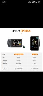

i order on AliExpress, you can choose one of these displays at the moment

yeah but those on aliexpress are marked for bafang motors, so probably you need to flash the tonshengen firmware/bootloader to use them? I saw a video somewhere so this might be good idea. I see EKD01 is on sale now at aliepxress so might pull a trigger.
the seller ships these displays with their motor kit, this must work or people would refund it, so i dont see the problem here.
I have no idea what you are talking about, you just pasted a screenshot of 2 displays and not displays shipped with motor. Paste a link to it? The only ones if I search them I get just displays for bafang and any tsdz8 from my results is equipped with VLCD5
PSW is selling few displays for Tongsheng. VLCD10 is the one I like most, but for it to work I think you would need a cable splitter 8 pin to 6 and 3 pin. Not sure where to get this cable. Also don't think brake sensors would work with this display.
