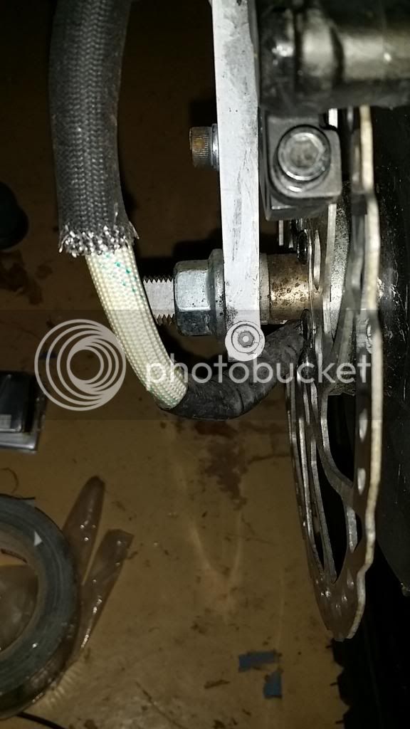

Today Motor arrived.
Looks good....
but...
The Freewheel Side has 17mm threads.
a single speed has only 10-11mm threads.
a 9th freewheel has 10-11mm threads too....
so 5mm left. :(
and from the washers delivered with the cro i need 50% more of them to fill the gap on Disc Side....
The Single Speed dont fit at this time without spread the 165mm dropout. (because Freewheel threads from Motor is to long)
no iam driving in a diy market and search about washers.

As the French say, Tuche'. So on the drive side you said you have 5mm left, is that between the freewheel and swingarm dropout? If thats the case, how much thread you have left on the axle for the axle nut to screw on to?
You just need another few washers or spacer on the freewheel side so the dropout tightens against that rather than the excess threads on the freewheel mount.
1mm on the disc side is cutting it close but as long as the caliper lines up then it's fine. I have had multiple bikes with big disc brakes that only have ~1mm of clearance from the forks or rear stays.
Search for casette spacer on eBay.
http://www.ebay.co.uk/itm/Splined-HG-Cassette-Sprocket-Spacer-Alloy-FIXED-singlespeed-conversion-HUB-GEAR-/191174456614?pt=UK_sportsleisure_cycling_bikeparts_SR&var=&hash=item2c82e2b526
You can get 2mm, 3mm, 4mm, 4.5mm etc

the washers are not the Problem. When i let the Freewheel in this position (it is fully tighten) i had to spread the dropout a few mm to fit the Motor.
Yes thats what i can do..but i have a 165mm dropout and i dont like to spread it because of a "to long freewheel thread on motor side"
Spreading dropouts i have done on all my bikes, and sometimes it is a pita to change a tire. i dont want spread nothing more except of my gf legs :mrgreen:
a buddy of me made some new washers and shortens the 8mm Disc-side adapter 3mm of. now i will try how it fits now.
Merlin, I'm am kind of confused about the problem you are having. Why would you have to spread the dropouts?
You can easily fit a single speed freewheel and rotor without spreading the dropouts.
Did you See my pictures? ;)
Look on the freewheel side.... Theres enough space for the Single speed right?
But unfortunaly the Single speed cant use the complete
Threads of the motor-freewheel-thread
3/4mm i have to spread the dropout in this "combination"
Iam still on the way to shorten some Aluminium and Steel ;)

I don't understand why the threads matter, I took some pics of my spacing. I have a Dicta Freewheel which happens to come exactly to the end of the threads.
But the threads don't matter, what matter is that you place the washer on that round piece that is under the threads and that sticks out past the threads. I marked this piece with the red arrow and the letters "cro". You can see this "cro" piece sticks out past the threads and then I put my washers on this.
Why would it matter if your freewheel doesn't go past the threads? You don't even need to put a freewheel on the bike at all, it wouldn't matter?
The reason I asked about thread spacing on the outside of the drop out was that a guy on the Phasor thread spread his swingarm out to 165mm. He commented how he didn't like the amount of axle thread left for the axle nut. Looking at your pic, doens't seem like an issue. I wonder if the Cromo V1 has a different lenght axle than V2 and V3?
