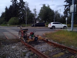

I was getting tired of pushing the bike/cart to cross the roads, so I decided to clean the gaps between the rail and pavement. I made a scoop to dig out the dirt.
But the job is a little harder than I thought. The dirt mixed with gravel and rocks been packed for years by passing cars and trucks. Sometime a fist size rocks wedged in that I needed a pry bar to dislodge the rocks. Up to now I cleaned 3 intersections.

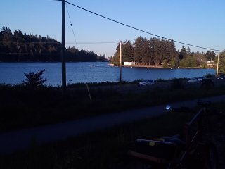

A trip from Long Lake to Green Lake
It's been cold and wet but finally weather gets nicer, so I made a trip.
Long Lake is where I have been testing my railbike. Bike trail runs along the track, easy to access and set up the bike.
Busy intersection, but because I cleaned the track, quick and easy to cross. Bike trail ends here.

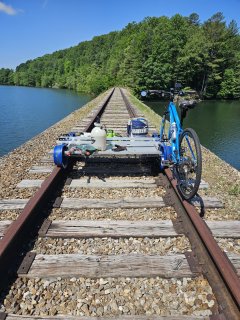

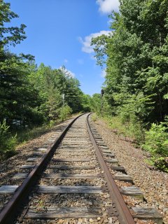

I finally made it to my goal of crossing the trestle over Lake Summit in Tuxedo, NC. Lake Summit feeds a hyrdoelectric plant as well as the Green river, famous for the Narrows and whitewater kayaking. My forearms and hands are sore from chopping down vegetation but it feels good to make it across. There is still a lot more to clear on the tracks but by switching the bike from one side of the cart to the other I was able to get through the thickest brush. Once across the trestle I had fairly clear riding until I ran into more trees growing up through the tracks, so I turned around. Next step is a GoPro video of the ride.

Maybe now you need to start designing a tree-eating buzz saw railbike to prepare your routes.
I have imagined something like that for pruning low hanging trees over the bike lanes.
But for real, it might be feasible to attach a motorized murderblade to your rig that you could turn on and advance by hand to clear at least the space between the rails. You'd be forgiven if that part used a two cycle stank motor.
Nice trip, looks like a beautiful ride. Your vegetation seems to be lower growing than what I am dealing with.

Lot of fun and interesting, like an expedition trip. I have never been here before because there is no road to get here. I got it easy I guess, there was no big tree like yours. Almost all were blackberry. They grow fast but easy to cut.
Now I made it to my first destination, there is another 200km track to go. Next destination is Nanoose Bay. But to go there, I need more battery or gas engine drive.
