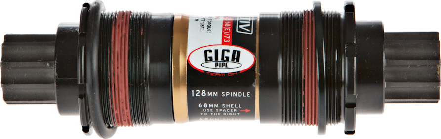

I may try the TruVativ Giga Pipe Team DH 128mm spindle with one of the ISIS trials arms if I come about some spending cash in the near future. Until then, I'm just going to have to suck it up.

Haha good point! I like the outboard bearing, but I think the bearing and the freewheel would be trying to share the same space. I have a pair of Isis trials cranks I want to put on my norco, but I think I'll go with the gigapipe bb. I'll post up some pics when I get it going.
Looking forward to it. :wink:

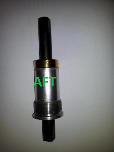

I don't know what BB cartridge AFT uses, but it has to at least a little better than the "lowest bidder" cartridge that the GNG comes with...
edit, they are $133, and the square shanks have no taper. They are used with very strong BMX crank-arms.
...Offset Bottom Bracket Cartridge 153 mm fitted with hybrid ceramic bearings that helps increase drivetrain efficiency...
http://www.af-tech.com.au/Products_Ebikes.html
$133 Standalone price
Yeah... I don't know about that one.
Edit: Actually, for those who are planning to use GNG's chain rings it's not too bad.
