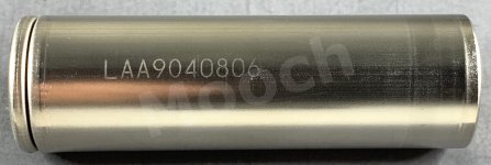

Hi everyone I need your help in identifying which cells is in the new Bosch procore 8ah battery.
What we know is for sure - 4Ah, 21700, tabless, cells without the wrap and with only marking on the tin being "LAA9M60601" and no spiral weld on negative terminal.
I have already eliminated known options from the list, EVE 40PL, Ampace JP40, Murata VX40, they all have different markings or a spiral weld.
So it must be some of the announced ones (bak, tenpower??), we also know that Bosch announced this pack over a year ago but we are only seeing retail units now. I haven't seen anyone use this format for the marking so I don't even know where to start lol.
Thanks for your help in advance!

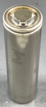

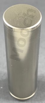

That code sure seems the same as used on the Molicel P42A (see images below), but that’s not tabless. Are we sure about that feature?
“M” would be a 2022 manufacture date in Molicel code, with the “O” in the P42A below (Moli uses confusing “O”, same as zero) being a 2024 code.
I can take other photos if needed to better compare to the Bosch cells. Check the size/font of the can code, top contact structure, can tooling marks, bending radii, top seal color and thickness, top and bottom surface finish, width and shape of crimp channel (around the can, just below top).

Ok I got some photos back, they look exactly like this lol, so we can say they are Molicels right, maybe some announunced or custom ones? I doubt Bosch would lie about them being tabless but they do perform weaker than Ampace, based on voltage drop they are in between Ampace and 40T's but that is considering the whole pack and interconnects, not just bare cells.
Thank for posting those photos! Wow, yea, those look like P42A’s.
IMO Moli wouldn‘t keep their first tabless cell ever from being announced. They have announced the P60B, P70X, P22S, P30S, P50S, XA1, XA2, and XA3 and they could still only sell those to a single customer for a year or two. Moli marketing I think would demand that they can go public with info about their first tabless cell, if it existed, so folks would stop thinking Moli was lagging in new tech development.
The newer Moli’s are also not using the can code anymore, just a QR-style code box on the bottom. Timing matters here though and I don’t know when the switch occurred and we don’t know when Bosch bought their cells. But it does push things a bit more towards that cell being an older one and not a new one.
Which Bosch pack is this? (Oops...Bosch Procore 8Ah) I want to check how they phrased the “tabless” mention.
Any chance one of those cells could be sent to me here in NYC? I’d be happy to test the cell and compare it to a P42A (performance and via a teardown).
