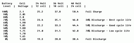

These must be voltages under load. Per the other graphs, and my experience, there's no way 2.0 volts per cell (12.0v for a 12v SLA) is above 50% capacity -- more like 20% capacity. The cycle life info sounds about right though.

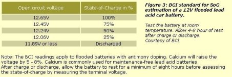

This one looks about right to me for open-terminal voltages:
I think alot has to do with plate construction... lead-calcium plate grids (which is what my Sla's are made of) raise the voltage by 5%to 8%
When my 36 volt pack of sla are charged up and have rested for 12 hr. the voltage is ~39.7 volts.

I start out at a resting voltage of about 13 volts (2.1 volts per cell) and end at 12 volts. (2.0 volts per cell) So I don't think that I'm cutting off at much worse than about 50% capacity most of the time. I usually don't ride the bike until it can't do anything anymore. (then it's no fun) Once I hit about 8 miles then I head home (usually starting from my track) and it's about 2 miles to get home. I very often end the ride right at 10 miles which for (3) 38 Ah batteries is not very long. My rides are nothing more than 2 miles to the track, six or seven laps and then 2 miles to get home... 30 minutes of riding.
There is an advantage in observng and obeying your SLA sag... by ending your ride early you do preserve your batteries.

Safe was specifically asking for 'resting' or open-terminal voltages (which isn't a particularly accurate method of gauging charge level but will do as a rule of thumb), so that's what I tried to provide.
As with any battery it's more meaningful to measure the voltage under load because sometimes a dead battery will still measure full voltage but can't provide any current beyond powering a voltmeter.
Perhaps more meaningful, but also less practical. Open circuit voltages provide a common reference for all of us without on-board current-measuring capability, as well as those with, as well as standardizing the reference for different system current limits.
