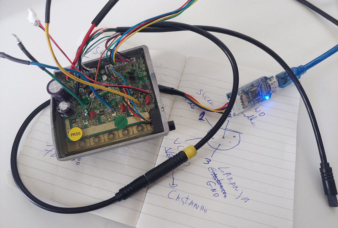

I got J-Link correctly connected to the motor controller, flashing and debug the blink firmware. Next I will document how to connect it.
Soon I will start playing with the motor but first I need to understand current motor firmware and figure out how I can connect a throttle so I can command the motor.
@stancecoke and @abrainer, can you guys help me on where can I physically connect the throttle as my controllers do not have throttle connection?
And on firmware, where can I see the throttle input being used?
Any considerations I should have to run the motor?

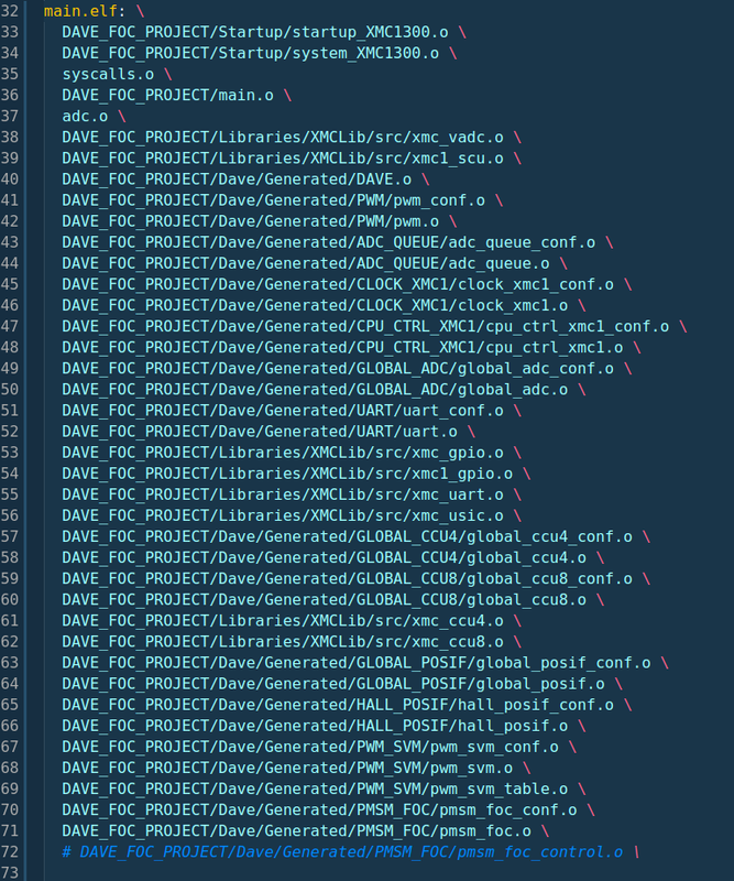

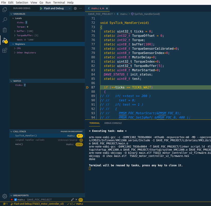

I wrote a simple Makefile to build the code inside DAVE_FOC_PROJECT. I can run and debug the code as seen on the following image. The idea is the tweaks to motor FOC code can be done on DAVE tool and other code can be added manually by us.
My next step is to get brake sensors working (to block FOC initialization, in case something goes wrong and the mosfets are in short circuit) and throttle working to define the motor current.

@abrainer and @stancecoke and other developers,
I have a very simple code that only reads the throttle ADC - I commented all the code for the motor control and the ADC throttle reading, but I added a throttle ADC code that I found on web and works.
Currently my Makefile is as shown bellow and the ADC interrupt and value reading works well, BUT, if I build the DAVE_FOC_PROJECT/Dave/Generated/PMSM_FOC/pmsm_foc_control.c (uncomment that last line shown on the image), the code builds without errors but will not work at all, I put a break point at begin of main but it never gets there :-( -- any idea what can be the cause??
@stancecoke,
I found the code builds and works until I do the PWM_Init():
if (init_status == DAVE_STATUS_SUCCESS)
/** Initialization of PWM APP instance PWM_0 */
init_status = (DAVE_STATUS_t)PWM_Init(&PWM_0);
For some reason, PWM_Init is making the code failing, it not even goes to main().
CLOCK_XMC1_Init(), UART_Init() and PMSM_FOC_Init(), all of them work, only PWM_Init() make the system fail...
Also now I the project on DAVE seem to fail, meaning we can not change the configurations...

I am trying also DAVE and the code also builds there and I can see the original Makefile. This Makefile seems to include other missing Makefiles, right?
A big issue is that I can not change / see anymore the configurations of the project, like I can't see the PWM configurations for instance. Can you please test this on your side?
I also tried a few times to use the debug on DAVE but it doesn't work. I installed the J-Link software and it did even update the J-Link firmware, so it is working. And after this update, it still works as regular with OpenOCD on my Linux.
