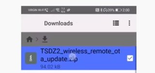

I'm sorry, but I can't find the file for the OTA update. See attachement
What do you mean? in which step are you from the Getting started? https://opensourceebike.github.io/
casainho said:
I am by this Step
See: How to Flash the Wireless Remote and Motor Controller Firmware.
Do I have to install anything on the wireless motor controller or do I just need the mobile phone app
mallesepp said:
casainho said:
I am by this Step
After you did install the bootloader, you need to install the firmware by wireless: TSDZ2_wireless_ota_update-xxx.zip

Thank you. But this is my problem. I don't found this file.
mallesepp said:
casainho said:
mallesepp said:
I am by this Step
Can you find it on v0.3.0 under the assets?

Thanks now I have found the file and flazed it on 2 dongles with nrfconnect. But now I'm hanging again. Both dongles seem dead. Shouldn't I see some LED light up?
The remote, after power up and if not connected to the TSDZ2 wireless board (you just need to not power it) will keep continuous blinking red and after some time like 30 or 60 seconds will stop that blinking. Does it happen to your board? Make sure you flashed the bootloader and then the firmware by Bluetooth.
STLinkV2 different versions: some don´t work for flashing TSDZ2 motor controller firmware
You can buy STLinkV2 on EBay or Aliexpress for very cheap price like 2€ (shipping included) but unfortunately there are different versions of them and some simple do not work well (at least for flashing the TSDZ2 motor firmware).
More information here: https://opensourceebike.github.io/stlinkv2.html
See two version side by side:
I saw "Verfy OK" after installing the bootloader. The firmware update with nrf-Connect ran as I saw in the video. But if I start nrf-Connect now I can no longer see the dongles! Also, no LED lights up on me.
