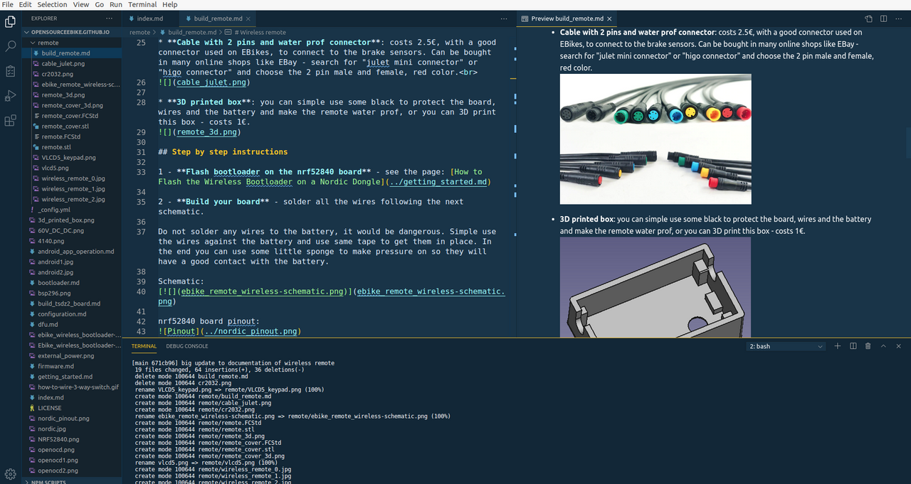

I did a good update to the wireless remote page: https://opensourceebike.github.io/remote/build_remote
If someone can verify, at least the english language :)
This is how I edit the documentation and have a live preview, using the Code Studio, both for this as for developing the code:
Looks good. I will give you some minor edits later today.
Question: how do you cut the dongle to avoid damaging the circuit?
We should probably put this in the documentation.

I forgot that detail. I always did cut my boards (with a simple metal saw, by hand) and the other ones and I never had an issue. For that 3D design, the board can not have more than 36mm -- I did cut just after the pads of SDWIO and SDWCLOCK.
