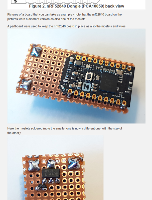

I added pictures of build TSDZ2 wireless board: https://opensourceebike.github.io/build_tsdz2_board.html
If any users have pictures using the correct board and transistors, please pass them on for use in the documentation.
Hello Casainho, sorry, I don't know my way around anymore? Why are there photos of the black dongle version in the manual? I thought the blue dongle is only being used?
mallesepp said:
Because no one shared good photos of that board build with the blue dongle.
