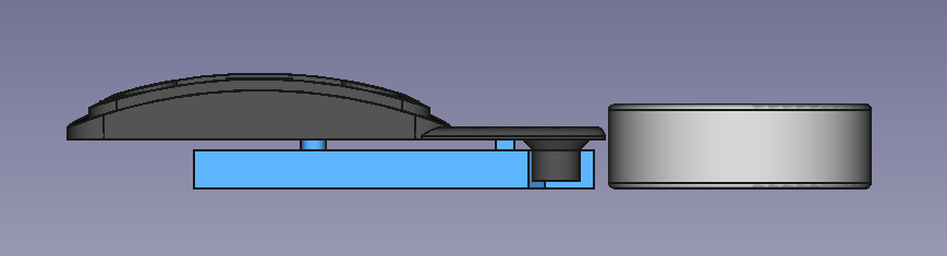

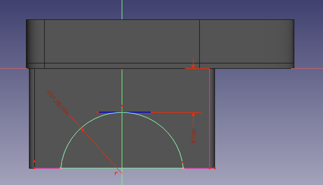

@casainho,
I was thinking about your excellent 3d remote design in the context of serviceability and battery life.
A typical cr2032 battery has a nominal capacity of 225mah, which I de-rated in my life calculations to 80% or 180 mah. This led to life estimates of 1.5-2 yrs in modelled usage scenarios.
The cr2032 battery is 20mmx3.2 mm in size.
However, battery life can degrade in high (or low) temperatures, and these effects are difficult to model.
So, I wondered what the impact of a higher capacity lithium cell would have on the enclosure.
It turns out that an inexpensive high capacity 3v coin cell is readily available that increases lifetime by 4-5 times! This would essentially eliminate any battery anxiety concerns that users may have with the wireless remote.
See: https://www.amazon.ca/dp/B07FMPQ84J/ref=sspa_dk_detail_1?psc=1&pd_rd_i=B07FMPQ84J&pd_rd_w=tJGuO&pf_rd_p=2c17e944-5508-41c9-9e34-6115f0c88f84&pd_rd_wg=B7rJw&pf_rd_r=36TGPE7REQBRR521PAF0&pd_rd_r=519f2211-b6a9-4cae-a331-7557d9a85e2b&spLa=ZW5jcnlwdGVkUXVhbGlmaWVyPUE3T0MyTDIyVE44VlgmZW5jcnlwdGVkSWQ9QTA5MTM5NTMxNklGTldXTVFPU0JWJmVuY3J5cHRlZEFkSWQ9QTA4OTgzNTQyTFFLSTlFRkdEOEhSJndpZGdldE5hbWU9c3BfZGV0YWlsJmFjdGlvbj1jbGlja1JlZGlyZWN0JmRvTm90TG9nQ2xpY2s9dHJ1ZQ==
They are 1000mah in capacity and are not a lot bigger, namely 24.5x7.7mm.
Using this battery would only slightly increase the case size.
I am not skilled enough yet with Freecad to make the necessary mods to your design to incorporate this battery.
Would you be willing to try out this modification?

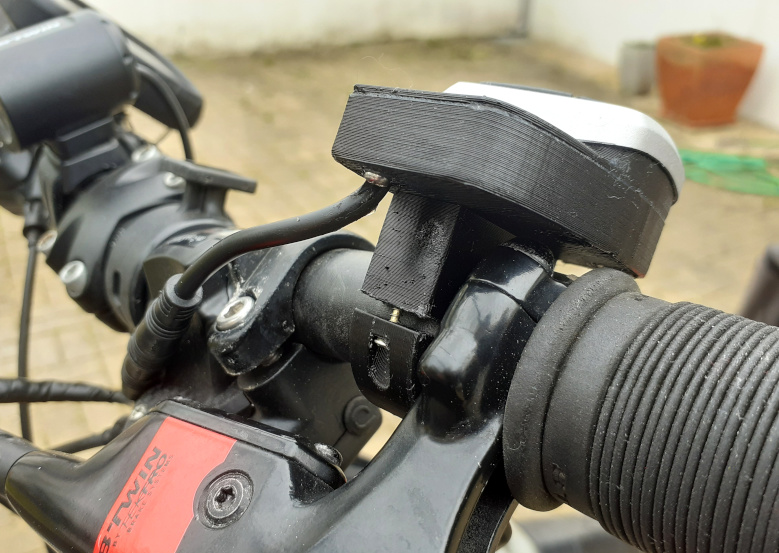

The Garmin Remote page says that: "Easily replaced CR2032 battery lasts up to one year, and features an automatic sleep mode to save battery life." -- so we are very good in having more than twice of battery duration. For my usage, I expect at least that time or even more.
Our remote is big compared to original VLCD5 remote or others and that is the only disadvantage, I need to have a big thumb to access the buttons, because the increase of height due to the space of battery + wireless board + wires. So i do not want to increase the size but decrease if possible.
I already looked at smaller batteries or simple use the same battery and see if I can reduce the height but the reality is that it took me several weeks to develop the remote and I am now tired, I do not want to do it anymore soon - sorry.

I certainly understand your reticence to modify the design. It IS a lot of work!
Anyway, I am not sure I am explaining well, so I just want to be sure we are understanding each other regarding my redesign suggestions.
I agree that your existing remote case is too high. I am suggesting an even thicker battery, which would make the remote higher by over 3 mm, right?
No, wrong.
I am suggesting you increase the overlap area (the part of the remote beyond the handlebar where the led hole is) by enough so that the battery is completely in this area.
That way, you gain two advantages:
1. You could make a pocket in the 3d print that would house the battery and completely eliminate the height of the battery in the enclosure. This would reduce the height of the existing design by 3 mm. It would also allow for larger capacity batteries if we wanted to do this.
2. You could add a removable cover to allow for battery replacement in this pocket.
Based on my battery life simulations, we would easily have 1 year of life with a 2032 battery. However, please do not assume you will have 2 years of life with a 2032 battery. IMO,This is overly optimistic. It is better to have an easily removed battery and replace annually.
Anyway, I certainly understand that you are done with the design for now.
If I get proficient enough with freecad, I will try to make these mods, or perhaps others may be interested in taking this on.
