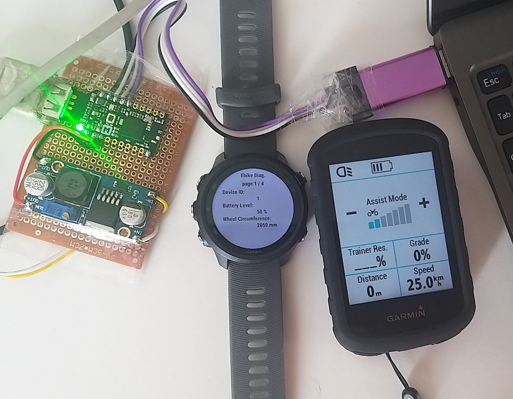

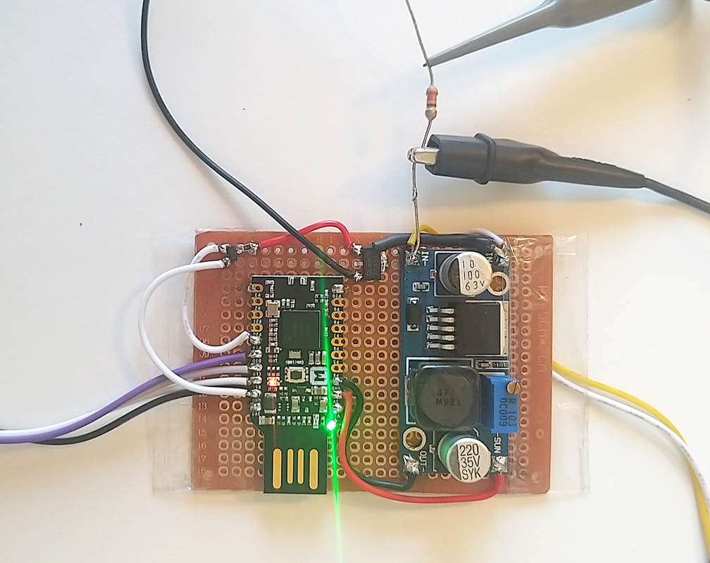

Finally got around to soldering pins onto my dongle for the STLink, my dongle is one of the blue ones (i.e. https://uk.farnell.com/nordic-semiconductor/nrf52840-dongle/bluetooth-module-v5-2mbps/dp/2902521) which appears to have a completely different pinout to the ones used in the schematics (can't seem to source the MDK version in the UK unless I wait for chinese shipping). It has a built in reset button but I couldn't find the RST pin exposed on the board so left that off when flashing and as a result the "NRF52 Flash and Debug" doesn't function correctly. To get it to work I have to "NRF52 Flash and Debug", wait for it to finish flashing, stop it, manually hit the reset button on the board and then run "NRF52 Debug".

And the ANT+ firmware is not working for me... it always disconnect but the Edge and SimulANT always receive 1 data package and then 7 wrong RX fail and then again a correct package. The firmware seems to not be resetting and even every data package seem to have the correct data format for what I see on the SimulANT. I need to solve this issue....

I'm fairly familiar with KiCad so when I get a spare moment I'll check out the pins and generate a new schematic for the blue dongle. Will probably also commit a footprint file for it too ready for pcb design
I think would be better to have only one schematic with clearly indication that user could use one or the other board - or maybe this could clutter to much the schematic? - because I wish to have the most simple and clean one, so users would not be afraid when see it - we need the bare minimum schematic and with clear wiring.
I got mine BTS4140N and I need to solder and test it... But my focus is on the ANT+ LEV now...

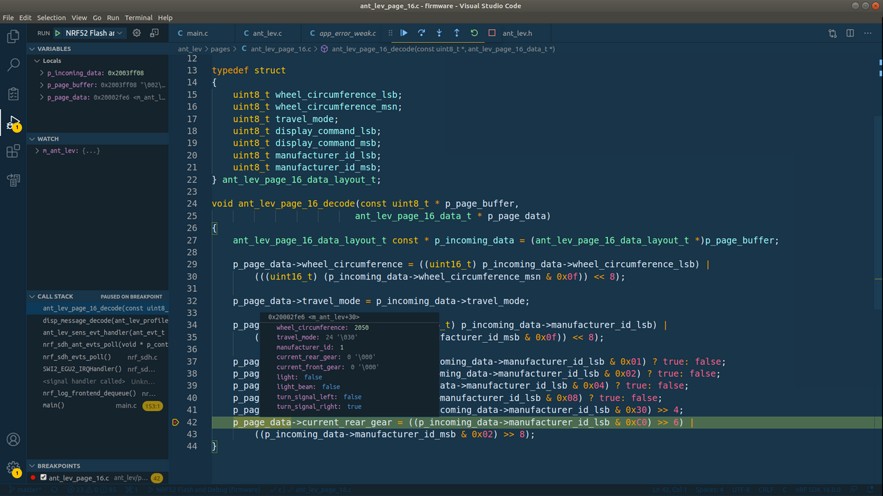

Turns out I was actually wrong about this, can only debug if I've flashed it via nRF Connect (even hooking up RST via the button doesn't work). The debug information appears to show it flashing correctly (and verifying it also shows its correct). I also verified after using nRFConnect and both show the addresses it is checking as correct so there must be something outside the hex file that openocd is changing which break it.
Also once I've flashed with openocd and then plug in via USB it boots straight to the programming mode so something isn't quite right.

wrote 225280 bytes from file /home/bob/workspace/NRF52840/TSDZ2_wireless/firmware/_build/TSDZ2_wireless_with_SD.hex in 6.423690s (34.248 KiB/s)
target halted due to debug-request, current mode: Thread
xPSR: 0x01000000 pc: 0x00000a80 msp: 0x20000400

Finally the ANT+ LEV firmware works!! the issue was the configuration LEV_MSG_PERIOD_4Hz 0x2000u // decimal 8192 (4.00 Hz). that was slightly different.
Here a picture of both GPS Edge 830 and Forerunner 245 watch connecting and showing information about the ebike. The watch is running a demo app that shows the ebike information / properties. The GPS on the other hand, show the information and let us change the assist level:
And here a breakpoint while in debug mode, on the firmware code that runs when I did change the assist level on the GPS display:

I got the motor voltage / power being turned on and off, this is the board:
The BTS4140N, I added a small mosfet with a 150K resistor otherwise it would not turn off. Maybe next I should try remove that mosfet and resistor and instead of change the microcontroller pin to 0 or 3.3V, I should change to 0V or as high impedance ? input -- will it work??
And a video showing this working -- changing assist level on the display and when value is zero it disable the motor voltage (turning off the motor) and enable the motor voltage when assist level higher than zero:
[youtube]P9KJfSMeXSI[/youtube]
That is correct.
BTS4140N Input pin floating = OFF
BTS4140N Input pin grounded = ON
If all the nRF pins are high-impedance on start-up this should be safe. Nice work!
Headless said:
That is correct.
That did not work. I removed the small MOSFET and changed the firmware for pin floating. Even with the 150K resistor in series with the in pin of BTS4140N, the voltage at NRF pin is "floating" at about 4V and so it does not work, with or without the resistor. The in pin has the battery voltage if we left it floating... So, I think the internal diodes of NRF get active as you said.
So, the minimum circuit is the BTS4140N + 150K resistor (other big may work as well) and the small n channel MOSFET. Can you please update the schematic?
And the schematic was updated by Bob, with the latest pull request, to add as optimal the NRF blue board.
Headless said:
Please can you confirm where the 150K resistor is connected? The datasheet is as below:-
Well, it is now in series with small MOSFET ouptut and input of the BTS4140N. But I will try to remove the resistor and see if it keeps working, it should. I will give feedback in 2 or 3 hours.
casainho said:
Headless said:
I confirm that resistor is needed, at least with the small mosfet I used: FDV301N. That resistor of 15K, there is 0.4mA crossing when the mosfet is turn on and enabling the BTS4140N.
Obviously it works, but the datasheet describes this as a logic-level device that can work directly with 3V devices? Mosfets (other than logic-level mosfets?) so far as I remember are voltage devices and don't need current-limiting resistors on the inputs like transistors, but beyond that...
One thing that does worry me a bit is that the FDV301N Drain-Source breakdown voltage is only 25V. If the Drain is pulled up to battery-voltage by the BTS4140N when the mosfet is off, it could be more than double that. Maybe this is why a resistor is needed? If any electronics experts can help, please announce yourselves!
Headless said:
I used FDV301N because was the only one small MOSFET I had with me.
Now I was looking to buy the BSS100 but seems it is kind of expensive and a bit hard to find. Maybe there are other popular options? I would like to find something cheap on ebay. BSS100 on Darnell, for instance, I could find to buy only 100 units which is to much for each user to buy as DIY, to build 1 or 2 units of the wireless board. Do you know any other popular alternative?
Ok, found the BSS123 that seems similar and I can find easily on ebay. Can you please check if this can work and then you can use it instead?
Good choice! It looks as though it's the replacement for the BSS100, same spec just not available in the old TO92 package. There are some projects that use it for switching LEDs, with the Gate input being 3.3V logic, so it should be fine - and with 100V Drain/Source breakdown battery voltage is not a problem!
I'll update the schematics tomorrow.
