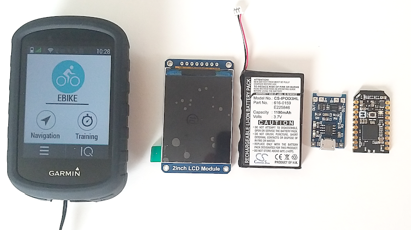

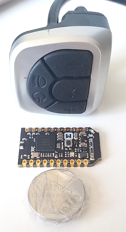

About the watch, yes, I would say 1.2 is the minimum size and the size of a regular small watch. Nice progress you got!!
Pine seems nice with the touch screen. But it could work just like the Garmin Edge, where you can use the wireless remote to change the pages / information while you are riding. (I wish to make with 3D print a wireless remote with 6 buttons, 3 for motor control and other 3 for display control, having a small size for an ebike and not like that big ones we can buy for motorcycles).
For the watch to work as a display, I would make it with similar TSDZ2 information as 860C display + working with wireless remote buttons + show user heart rate when it is broadcast by wireless from a smart watch. Heart rate with zones information is really good for workout!! I do not expect other advanced features like navigation or any other fitness metrics. Well, maybe working as a secondary display on ANT+ profile, meaning mirror data that is on the user watch and that can be advanced fitness metrics.

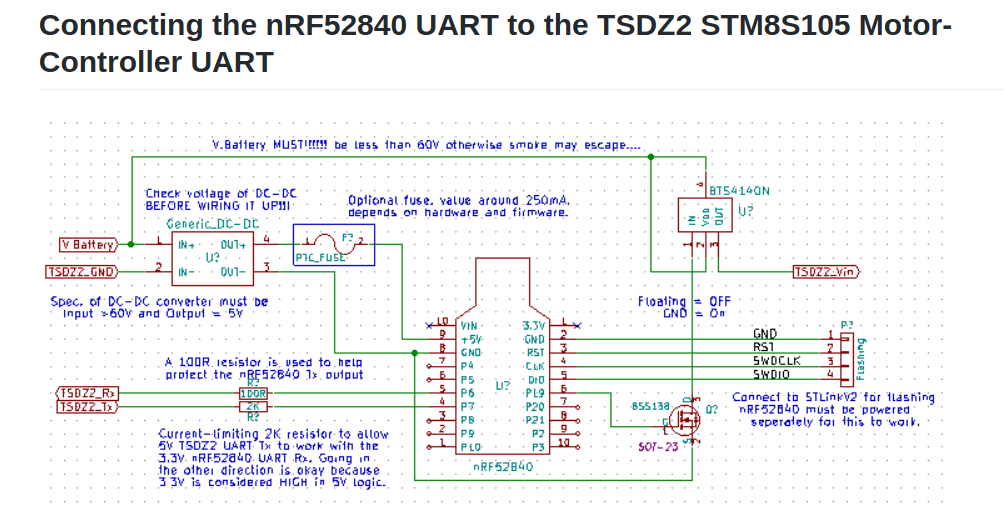

@bobreece20, I received my BSS123 mosfets and I tested with both the resistor and without and it works on both cases, so, no resistor needed as expected. So, the schematic this schematic is correct - can you please update the mosfet referent to BSS123?
And I think is very important to share knowledge and technology for ebikes as OpenSource, so, I am very happy to see detailed notes on the schematic!! BUT, I also think all that details makes feel difficult / hard to DIY the board... for a final user version, I think the schematic should be simple as possible and without technical information, my reference are the Arduino https://fritzing.org schematics with colors on the wires:
@bobreece20, could you please make a very simplified schematic version (can be on Kicad) for the users that just want to follow a simple steps? if they want more information, we should link to the full notes schematic version. Also note that letters should be big to be easy to read and with good space between wires, again, to be easy to read.
I am a bit tired of trying to get UART working on the firmware, using the latest SDK of Nordik...

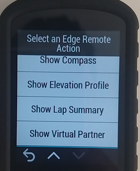

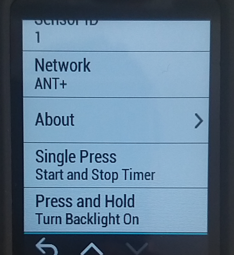

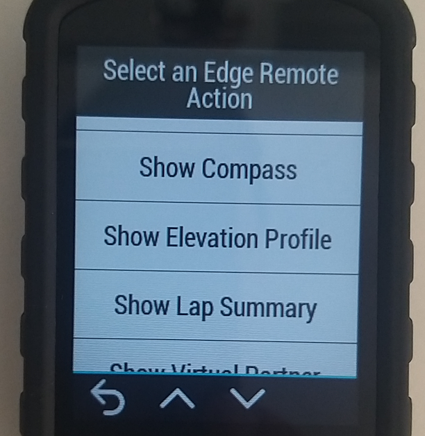

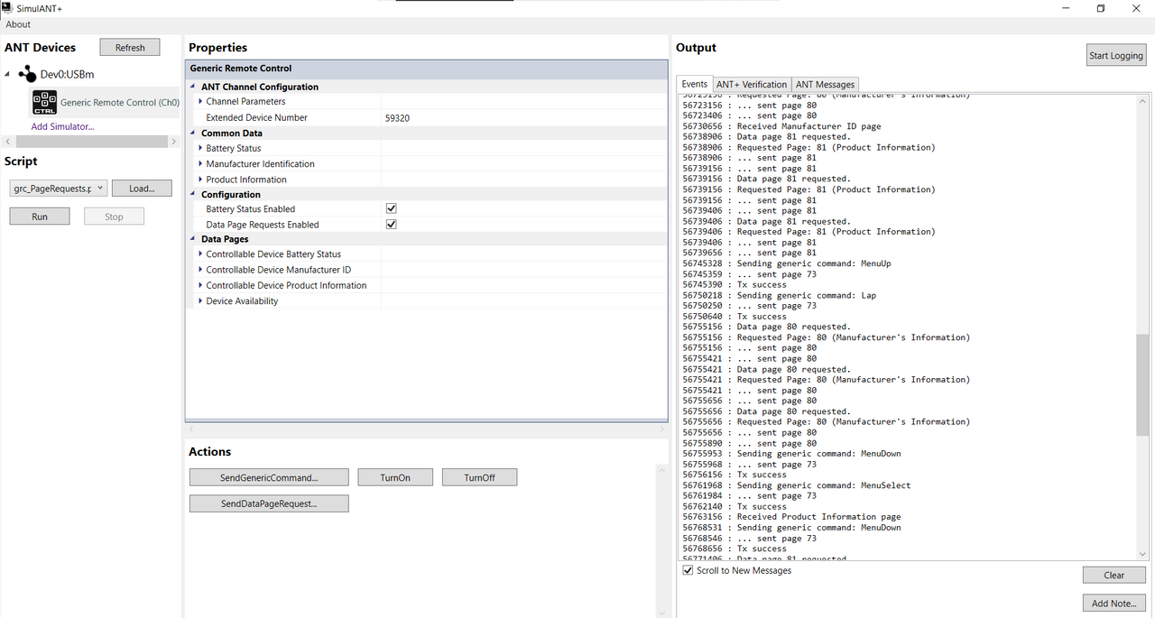

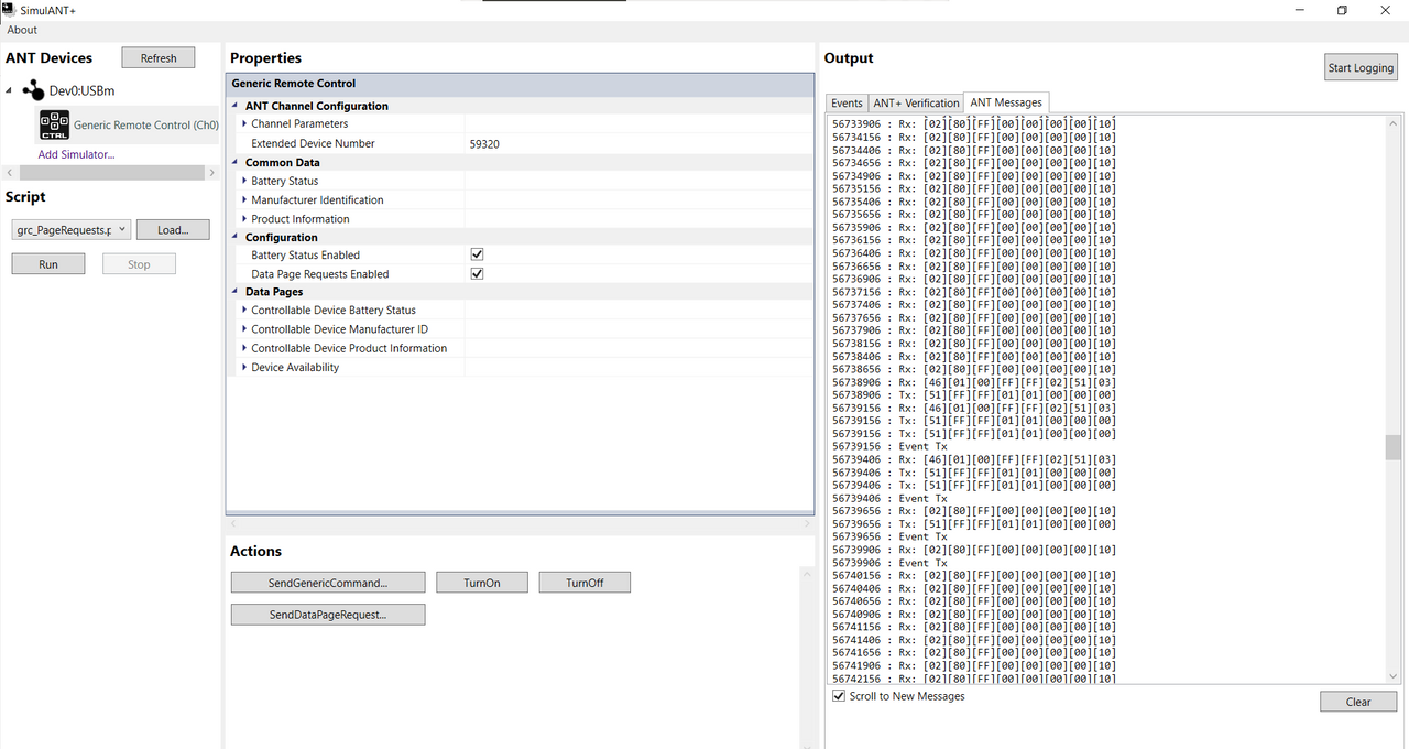

Meanwhile I tested using ANTSimulator (Windows only) to simulate a remote. I tested to send the command 0 and it simple switch the Edge pages.
My plan to chill out a bit, is to quick develop the firmware for having an Edge Remote, that let me change the Edge pages while I am riding. This firmware can after evolve to the ebike remote remote button:
ANTSimulator working as a Generic Remote:
And the configurations on my Edge for the Remote sensor:
The last option is "Show map":
Thanks @bobreece20 for updating the schematic and documentation (using a pull request).
As I want to make my own remote buttons, I started to design an enclosed on FreeCAD for reusing the VLCD5 remote buttons board and pad:
And the schematic draw by @bobreece20:
file.php
Although I have been updating the schema I cannot take claim for the original creation and that one in particular is not one I've touched, I believe it's from @Headless. It would be good if we can get it in github though so it can be updated if needed :)

And I also received the IPS 2 inches LCD I bought. Here is the LCD, battery, battery charger board and the wireless board with the microcontroller. The idea, that I don´t know if I will find time to do it, was to design and 3D print the enclosure for all that to make a cheap wireless display to show the same information as 860C display + user heart rate. The possibilities are customizing for a bigger or smaller battery as also wireless charging instead of using micro-usb:
