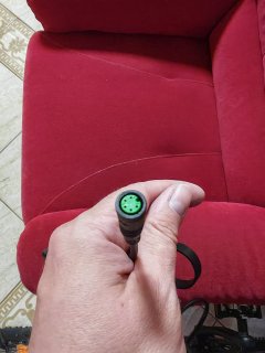

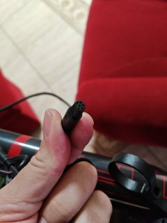

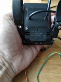

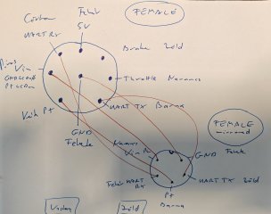

Can somebody help me please in wiring. I had a tsdz2b kit with 850c, I changed the display to 860c and I flashed the motor and the display as well. Now I cannot connect them due tó the different connectors. 5 pin on display and 8pin from motor splitted to a 3pin to throttle and 6pin to display. I found several pictures but with different schemes and colors, I cut the heads/connectors off, I identified the cables to the connectors, but what should be linked to what? Pictures attached.

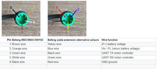

Here is the location/function of the pins on the connectors, don't trust the colors.
Also consider that M and F are mirrored.
If you are not familiar with a tester and soldering iron, it is better to purchase a ready-made cable.

Thanks. I made the checks with tester, connected the wires taking into account mirroring female/male I also tried switching tx/rx, but it is not working. Screen comes up, but turns off, when I release the button. Can you please check my connections on the pictures? If it is good I will re-upload the firmware to the motor.

The connection seems ok, perhaps TX and RX need to be reversed, but you say you have tried.
Have you checked if the colors match?
How did you make the connection?
I didn't understand if the display now stays on.
When it's on, between Vin and GND you should measure the battery voltage.
Are the display and motor the same firmware version?

Colors of wire is the same as on the pictures you provided. Motor firmware hex file is the same as the display shows. Display does not remains on, it is on only when I push on/off button and it shows only the waiting screen for the motor.

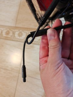

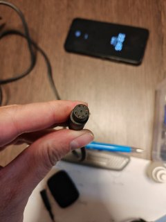

Took a chance and bought a new Bafang 860C LCD Screen from Aliexpress after having to change the Tx and Rx wires over I was able to upload the firmware on to it. The DC-DC Adjustable Step Up Power Module and the Higo 5 Pin waterproof cable came from Ebay. Just waiting for a TSDZ2 mid drive to arrive to update the firmware and fit the additional bearing to the pedal arm axle. So far so good see what happens when I am able to power the whole system up on the bench.

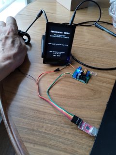

Hi--
I'm trying to flash a SW102 and then will flash the firmware on my TSDZ2. Following instructions on the wiki:
"The firmware on SW102 can be flashed by Bluetooth (and you will do thatevery time you will want to update the firmware to a new version), BUT,only after our bootloader and firmware are flashed a first time usingSWD connection -- see here how to do it: Flash the bootloader andfirmware on SW102 usingSWD."
That page is 404. There's a firmware release linked below that page on the wiki for ota update (after first flash) that points here that mentions "sw102-otaupdate-1.1.0.zip"
Does anyone know if you can flash this firmware using the SWD pins?

Ok I'm gonna try flashing using a st-link to flash the SW102 to 0.19.15 release above, then immediately use OTA to update to v20.1C.5, which I will then use the st-link to flash the motor controller to.
Welp, wrinkle #1: The SW102 I have seems to be a different revision than the one in these pics. I cut the side panel off, no pads. Also, the board has blue mask, not green. Cut the other side panel off, found the relevant pads, they're on the bottom though. Going to be very tricky to solder this, and will probably require destroying the case. I don't seem to have any header lying around that's the small enough pitch (it's very fine).
Motor firmware upgrade is only open hex file, program all tab, that is it? No other parameter, change is needed? (Here java configurator type of thing is needed?)
For the motor, ST Visual Programmer must be used, with the .hex file only the PROGRAM MEMORY tab must be flashed, not the other two!
If you have flashed them, read the OPTION BYTE tab from the motor, check Value must be 00 00 20 00 00 00 00 00 00. If not, edit, save and flash.
However, this does not affect the switching on of the display.
Have you checked the voltage?
Between P+ and GND there must always be the battery voltage.
Between Vin and GND there must be the battery voltage when the display is on.
If it is not there, the 860C is damaged.
