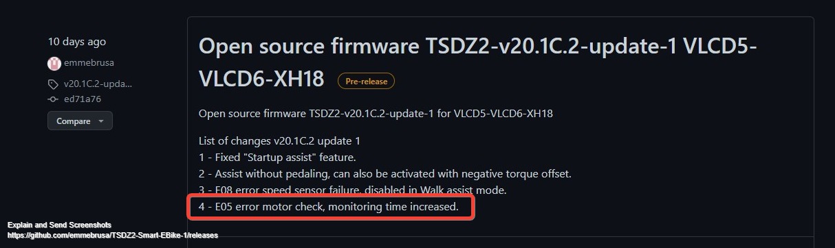

i did a hardware calibration of Tqsensor getting much better range . then added temp sensor and everything was fine . during test ride nothing bad happened . next day i went on short ride (20 min) and at the end error showed up...then i did software calibration of Tqsensor and nothing helped (64 <--> 260 , adc = 166) . i opened the case to check for damaged wires but everything seems fine . i know it can work with error however am not able to turn this option with vlcd6 . can i hardcode this somewhere in code ? it will be dangerours for motor ? will motor consume more energy or might overheat ?
i see there is something mentioning this error in latest rel ?
should i be interested in ?
mbrusa said:
I did not understand if E05 error motor check, is always displayed.
However in the latest update, the handling of E05 has been improved to avoid false errors.
If you haven't tried it yet, give it a try.
it appeared , then was gone but motor didn't assist .

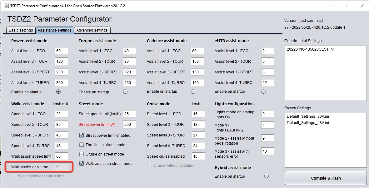

can this be set for longer ? i assume this extends walk assist , it could be longer than 3 seconds when pushing bike on steep rocky mountain slope its hard to constantly keep vlcd6 button pressed

hey
got new release , no luck . went on short trip , bike worked fine for around 25 minutes then e05 and no assist . reboot did nothing . reflash with new fw - no luck . tried torque mode instead of power mode - no luck , then tried e04 assist with sensor error - still nothing ...display shows speed , walk assist works , pedal assist not ... what else can i check ??
mbrusa said:
So now the situation is this:
When pedaling, the correct speed is displayed but without assistance, no errors displayed, the assisted walk works.
Did I get it right?
Try it in cadence mode.
Post the ini file.
hey. thank you for help . I think I found the problem. one way bearing in blue nylon got rusty and stuck so the motor rotated with cranks and that apparently was causing an error . got replaced and testing if this was the problem . will report later .
once again big thanks for help .
