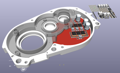

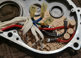

I got quite some questions regarding the motor controllers we designed recently and it looks like people are afraid to solder it and want something ready to purchase without touching a soldering iron, or at least something easier and cheaper to fabricate.
And it looks like there is a possibility to design such a motor controller for Bafang M620 motor that would be possible to easily order from JLCPCB for cheap or at least solder it home in your kitchen on your cooking hot top in one single step.

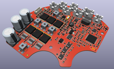

Here are the requirement we probably can meet for such controller:
- The controller must consist of one single PCB (to reduce the price and simplify the fabrication)
- The controller PCB assembly must be single sided (to reduce the price and simplify the fabrication)
- The components spacing must be regular (to reduce the fabrication diffculty)
- All the PCB assembly components must be SMD components including connectors, terminals and so on (to make the fabrication one single soldering step with no soldering wires, no soldering through hole components and no post processing to reduce the price and to ease the fabrication)
- All the components must be pick and place components including the terminals and connectors (to make fabrication through JLCPCB cheaper)
- All the components sizes must be 0805 or bigger (for easier placement and soldering and no need for a microscope and such)
- All the components must be sourced and available from JLCPCB and be accessible through their PCB assembly service (so you just simply load the BOM and pick and place files on their website and be ready to purchase the controller without extra hassle managing the parts).
- The components must have common packages (so you can find replacements in case of lack of the exact parts)
- No integrated Bluetooth module (a Bluetooth module can be purchased as a separate dongle and connected to the PCB with a connector)
- The controller PCB size must be 100x100 mm or smaller (to reduce the PCB price)
- The controller must be plug and play and be able to come from JLCPCB as a complete unit without a necessity of extra work (so a person who has no idea what soldering iron is does not need to touch it and just need to install the complete controller in the motor using the existing parts)
So if we will be able to meet those requirement anyone should be able to purchase a complete controller PCB assembly from JLCPCB without a hassle and spending too much money and no need to find a middle man.
I starter moving the parts around and it looks like there is a chance we can design such a motor controller. Do you think we can make it?

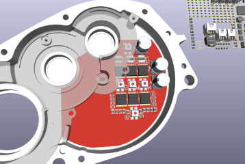

Aren't you concentrating on the wrong motor, the M560 will put out nearly the same power, smaller format and much more available as its now the latest motor from Bafang ( waiting for a ECVT, it can't be far away ). If you put all the above criteria into the M560 layout you would also cover the M510. KISS is great for the most builders.
It is impossible for the M560 motor, there is not enough space. The existing design of the INNOTRACE M560 controller is already crammed. M620 is the only our chance to design something simpler.
But even for the M620 there is not much room left for the remaining parts, it is going to be quite a challenge even for M620.
If you can make an electronics newbie-friendly 'take and bake' controller, that's also super compact, i may be interested.
I am not sure if 100x100mm PCB is super compact but if it is then this is the one. It can not get significantly smaller than this without using smaller footprint components and jamming those closer to each other which is more difficult to solder.

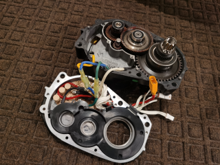

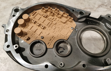

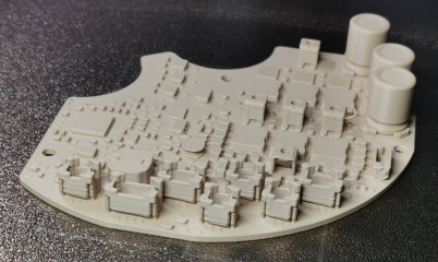

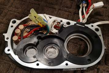

It is time to 3D print this bad boy and check the fitment before moving with tracing

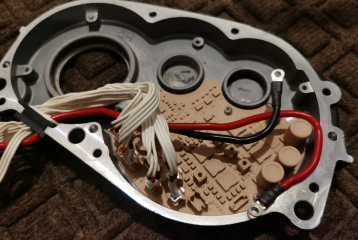

The controller has been printed!

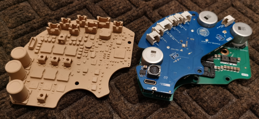

The new easy cheap INNOTRACE vs the old difficult expensive INNOTRACE

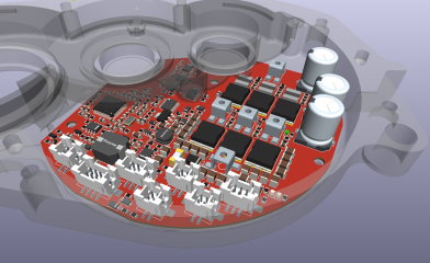

I looks like we nailed it guys! The controller fits the motor just perfect! The cable management can't get any better

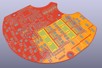

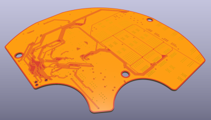

The high current tracks are mostly complete! That should be able to handle quite a punch!

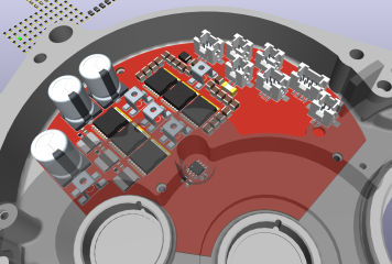

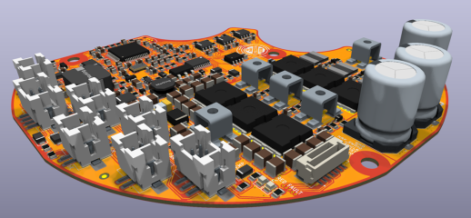

The controller design has been complete! And we managed to squeeze it is 4 layers, so this motor controller should be dirt cheap!
Working on the PCB assembly files for JLCPCB. The good news is all the parts are available! Still a lot of stuff needs to be fixed though, but we are getting closer so we can purchase the complete controller directly from JLCPCB without touching a soldering iron guys!
The assembly files have been finished and the order have been placed. That means only one thing - it is the time for the release of the controller files. The KiCAD files are for KiCAD 10.0.5

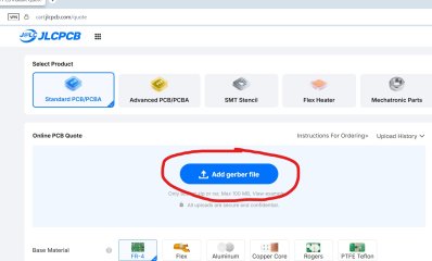

So if you want to purchase this controller here is the process (of cause regardless our 100% success rate there is no guarantee it will work, no one tested it).

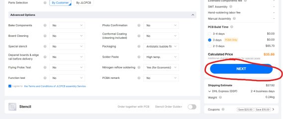

1) Go to the PCB Prototype & PCB Fabrication Manufacturer - JLCPCB website and register an account if you do not have one. If you have one log in with your account.
2) Select "Get Instant Quote"
2) Select "Add gerber file"

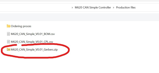

3) In the opened Windows browser go to the folder "M620 CAN Simple Controller\Production files" in the controller files archive and select the file "M620_CAN_Simple_V0.01_Gerbers.zip"
4) Wait until the JLCPCB finished processing this file and select PCB thickness 1.0mm
5) Scroll the page a little down and select Material Type "S1000H TG155".
Also select Via Covering "Epoxy Filled & Capped"

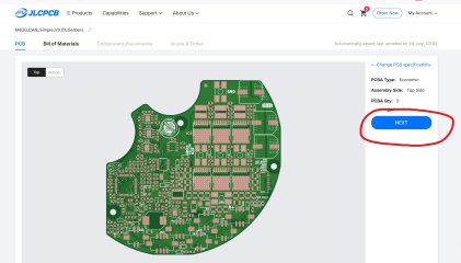

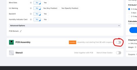

6) Scroll down and click the switch against the PCB Assembly
7) Selct "NEXT"
8) On the next page select "NEXT" again

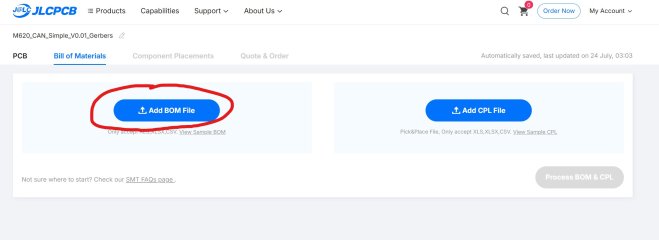

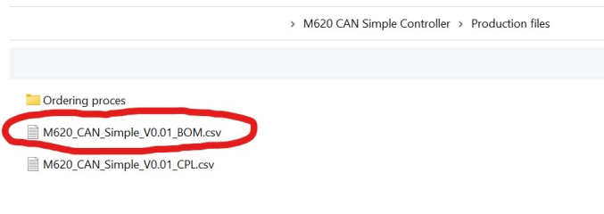

9) Select "Add BOM File"
10) In the opened Windows browser go to the folder "M620 CAN Simple Controller\Production files" in the controller files archive and select the file "M620_CAN_Simple_V0.01_BOM.csv"

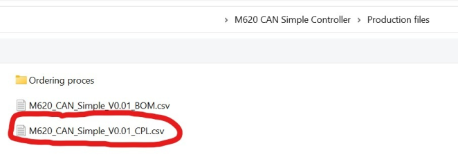

11) Select "Add CPL File"
12) In the opened Windows browser go to the folder "M620 CAN Simple Controller\Production files" in the controller files archive and select the file "M620_CAN_Simple_V0.01_CPL.csv"
13) Click "Process BOM & CPL"

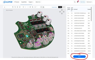

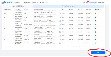

14) On the next window check the bill of materials list and make sure JLCPCB has everything in stock. Then select "NEXT"

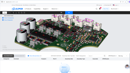

15) On the next page wait until JLCPCB processed the BOM and CPL files and check the parts placements in the 3D view. Make sure all the parts are oriented and positioned correctly. I adjusted the KiCAD files so the assembly files work without issues and no extra action as is with the JLCPCB, but if you replaced some parts with different parts on the previous page for some reason make sure those parts are oriented correctly because of orientation of the parts may differ even the parts have the same footprint.
If everything looks good select "NEXT"

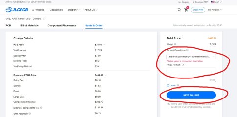

15) Select Product Description as "Research/Education/DIY/Entertainment/D... "
Select "SAVE TO CARD"
16) Select "Continue" and finalize your order with your shipping address and payment. As you can see 5 of INNOTRACE M620 Simple motor controllers cost about as one EXFORCE M620 motor controller. And if you order more the price per unit goes down. You can offset your expenses just selling the rest of the batch you ordered for the people who wants it.

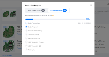

The design for manufacturing inspection has been passed with 0 warnings! The controller is 13% complete! Less go!
