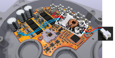

Btw - can the controller have a build in step down with meaningful current to support reasonable lightning without external dc-dc unit?
Probably can if you go back to design with two boards to have more space. The connectors for lights for this controller are occupied for different purposes though (USB, Bluetooth, CAN).
But the best solution would be just to purchase a module on AliExpress, a connector for the light cables, terminals for the connector, some ring terminals and heat shrink wrap and make a dongle and put it inside the motor.
You still need an external stuff to control the lights or at least a BMS with turning power off function. But if you want to control the lights from Bafang Display you need to figure out how it meant to control the lights (probably from CAN bus) and most likely design a module with an overhead like transistors circuits controlled from MCU to control the light module. And you can implement all bells and whistles like tail light with run mode and stop signal, turn signals and a bunch of other stuff. Of cause we are not going to do this since it is too much work and no-one is going to use it anyway.

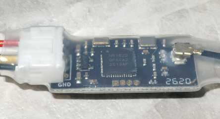

The Bluetooth dongle is compatible with nrf51_vesc ecosystem Makerbase MKS ESC_BT V1.0

While we are waiting the controller delivery we can prepare the Bluetooth cable.
You need a 2x2P (4 pin) PHB 2.0 connector and terminals for 26AWG.
2x2P (4 pin) PHB 2.0 connectors can be purchased here
28-24 AWG terminals can be purchased here
Chop the original Bluetooth cable terminals off
Strip the wires and crimp the PHB 2.0 terminals on the Bluetooth cable. You can use this crimper
Attach the wires to the PHB 2.0 connector matching the pins to the Bluetooth module connector pins in the KiCAD schematic
The cheap 7 pins JST GH 1.25 cable for firmware flashing fits good and you can use it instead of the more expensive Tag Connect cable to connect an ST Link V2 dongle to flash the firmware.

7) Attach the battery leads to the controller following the GND (black lead) and B+ (red lead) indications on the controller PCB with M3x6x6 terminal block screws. Do not overtighten the screws. The image below indicates the proper leads routing.
