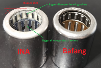

I think we need one more attempt with INA. I purchased a new M560 clutch and a new INA. This time there will be no extra lubrication and the clutch race will be fresh with no wear.
Already extracted the original one way bearing
By the way, you can see the Germany made INA overrun clutch has thinner shell and larger rollers for bearings and for the the clutch than the Bafang overrun clutch. Let's hope it will make the trick.

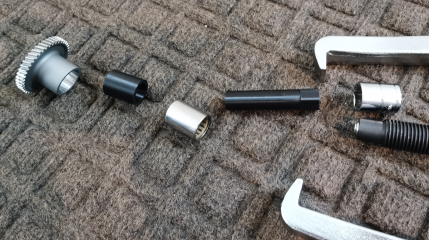

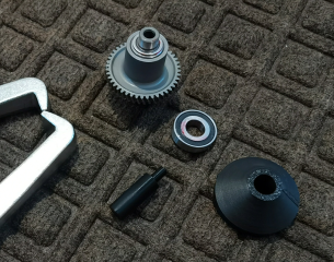

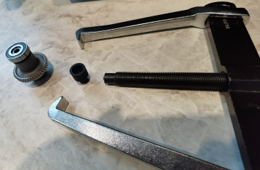

If you want to replace the overrun clutch you need this tool
You also need a 9/16" socket or similar with the outside diameter slightly less than 20mm to push the overrun clutch.
You also need the adapters. The adapters are 3D printed parts, I used PLA. You can download the CAD models here and you might need to adjust the adapters sizes depending on your 3D printer tolerances and the tools you have
The clutch gear I obtained from AliExpress has no markings on it while the M560RS gar has markings. I also noticed the the thin washer between the bearing and the overrun clutch is metal on the AliExpress gears while this thing is plastic on the Bafang M560RS. Let's hope this is the correct part and not a counterfeit.
It turned out the clutch gears are different. They have different teeth angle. How do I know which one to purchase?
I does not sit parallel on the M560RSs main gear.

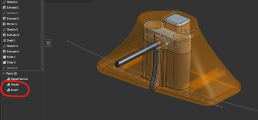

Finally got rid of the foam and made a proper speed sensor bracket. If you have a Kunlun frame and want to use it with this controller you can 3D print this one optimized for FDM 3D printing.
