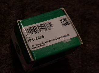

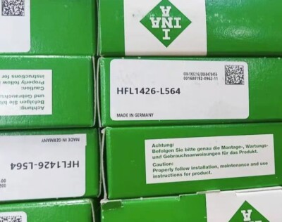

Ordered an INA HFL1426-L564 one way bearing on eBay. Will see if it will fix the issue

INA HFL1426-L564 has arrived. Let's hope this is the real one made in Germany and not a Chinese counterfeit. It looks slightly different than the pictures I found in the Internet like here for instance, so who knows what the Chinese guys sent to me.
I believe this is the one Luna is talking about here. Will see how it holds the power. That thing is quite expensive, even ordered from China.
