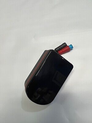

Hello. I am new here. I recently got a small electric scooter that looks like a Lime one and I understood that I have to buy a new battery and a controller to it. Okay, I found them, but there is something that concerns me. I connect the positive and negative wires to the battery, but how do I charge it? There is a circle connector on the front of the scooter that has two wires on the back but how do I attach them to the controller? Also, does anyone know where exactly to put the throttle, that is near the display, to the controller? I am providing images and a link to the controller. Any help will be very appreciated. Battery has only one output or input that is XT60.

Also you can reccomend me another controller that is better for beginners (haven't ordered one yet). All I want is to transform it to a personal one but do not know how to charge the battery. Here is another one Other controller
Sorry, I can't see the battery or any of the things you're describing. Did the battery not come with a charger?
The controller doesn't charge the battery; the charger that comes with the battery is used for that.
If it didn't come with one, then I'd recommend asking the seller for one that is specifically compatible with the battery you bought from them.
Without knowing exactly what parts you have on your scooter, and what their wiring is, we can't tell you how to connect them to new parts. At minimum you'll need to provide some clear well-lit pictures of what you already have. Once we can see those, we can ask for other info about specific things, and tell you specific tests to do with your multimeter to find out other things.
We'd also need complete info on your battery, if you want advice on it's compatiblity with what you have or need to get, etc.
The image you posted is of a controller that appears to have no throttle input connector. Presumably it's just a PAS-type unit, with the 1:1 assist meaning a cadence sensor connector. If you don't have pedals on the scooter, it is unlikely to work for your usage.
The first controller link you give requires you to use the display/throttle that comes with it; it wont' work with a regular throttle.
The second controller link says it has a plug for "speed throttle" that is probably a standard hall throttle input. If the one on your scooter is a standard hall throttle output, then they can be connected and work, otherwise you'll need to buy one that matches your controller.
It looks like the image is of the same controller in the display/controller combo linked, so no PAS or throttle inputs to the controller. Looks like a second throttle is necessary to use the variable braking function.
If it has actual variable braking, then it probably uses one of the various analog-output ebrake levers, rather than a throttle. At least two are linked in my "how to make a variable regen brake lever" thread; I'm sure there's plenty of kinds out there nowadays.
