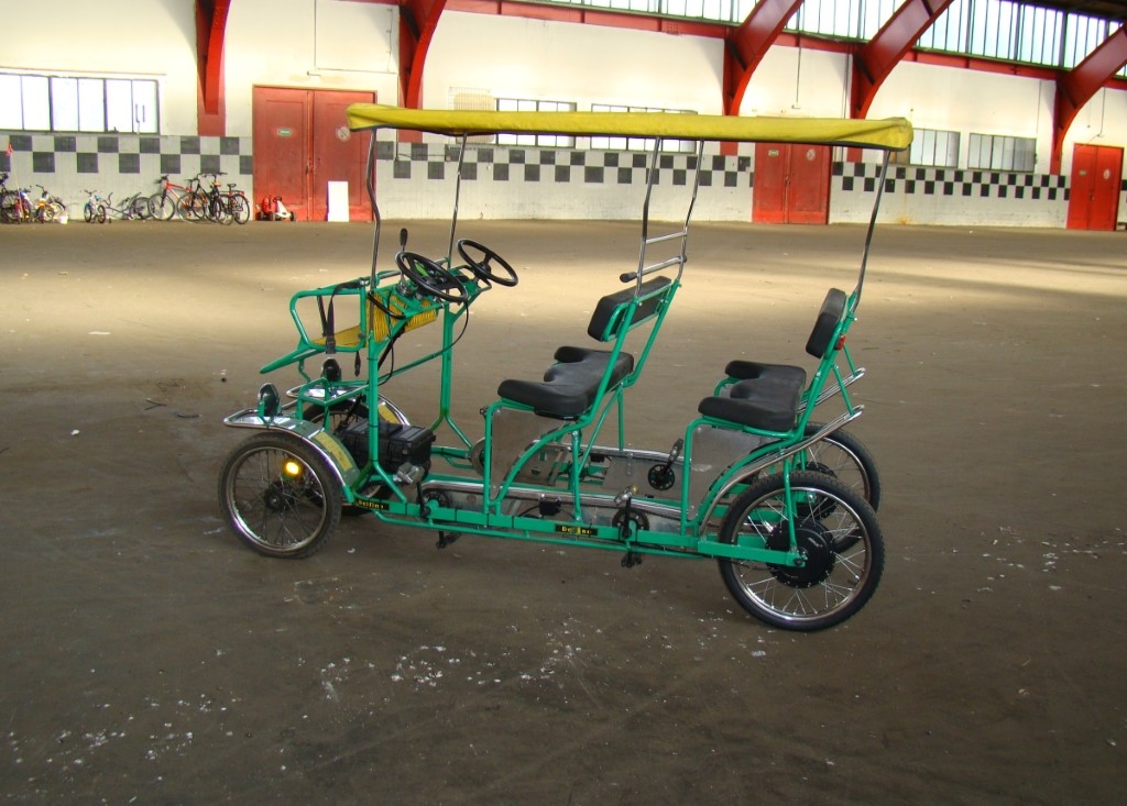

to not only writing about not so good things, attached pics belong to nice things :D
