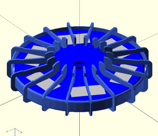

For the coreless widings, as far as I can tell it can be done much more simply. Screenshots of what I have here, not all that clear but maybe a help:
Cage and rotor:
Windings only, end turns not shown, either carry on up and down for stacked rotors or loop around every 3rd set
Assembly plus a small amount of shielding:
If the magnets are back to back, like poles to the outside, that winding configuration should be correct. An alternative arrangement would be round magnets with steel between, like a doughnut. That would make use of the windings going over the outside as well as the faces but would be a lot harder to machine.
I'd drawn that one up to suit some small rectangular magnets I have here but for a decent controller round magnets would probably be a better option, should give close to a sine wave. Rectangular would probably be the better option with RC ESCs.
I'm not sure how much magnet is ideal, more should give a lower Kv but I've not done much with the calcs, I'd drawn this one up to get a handle on what's happening and see what needs tweaking. Commercially available coreless motors seem to use a hell of a lot of copper in relation to the amount of magnet, that's a really crude way of looking at it and they all tend to be really high rpm but FEMM seems to confirm it, the only way of getting reasonable amounts of torque seems to be masses of windings.
There doesn't seem to me much benefit over using cores, little to no weight saving and craploads more copper. Aluminium windings have been warned against and I'd be wary of them but they seem to be the only option for choosing coreless over cored, there could be a considerable weight saving.
