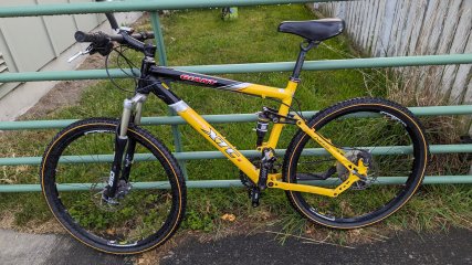

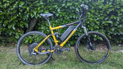

Those inexpensive DTC ebikes are built out of the cheapest parts, so you'll always be chasing your tail if you try for a reliable, higher speed ebike. I prefer to convert a quality used bike.
This beauty was $50. Added the Grin motor wheel and controller, and EM3CV battery.
Full suspension, regen & torque sensing, 30+mph on throttle. Great bike until motor broke. :(
