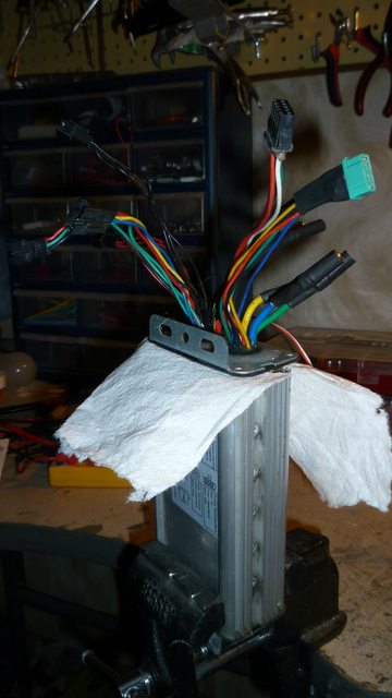

I filled it in from the inside first going around the edges since I can't spread the wires open to get inside the bunches. I did the inside and then let it dry a bit so that when I did the other side it wouldn't drip down inside the controller.
Looks good. The stuff works as promised.
Don't want it to run or get get on the controller!

Well this has been sort of a frustrating night. First I was about half way through filling the cotronller when I noticed it was leaking. So I guess the gasket wasn't good enough. So I got out the blue rtv, and went to town.
After closing it all up and letting it dry for an hour I went for a spin.
Second frustrating thing. My temp sensor is now on the fritz. Just like the one in my motor that died right away. So mad. Cheap chinese hobbyking vt bullshit. Must be a bad batch as the one in my old motor lasted a year. Well, I have to replace the one in my motor......andddddddd controller seems to be still leaking so I'll need to open it up and redo it. Don't know if it's from the vent tube that's leaking or the gaskget. I tried to clean off the mineral oil with paper towls, a tooth brush, and rubbing alcohol but oil is everywhere. It might of caused the RTV to not take. My whole house smells like a clean babies butt.
Fill hole and vent tube. I used an ecig juice bottle to fill it up. Took ~300ml.
Now the good news. This mod does work. Did the 3 mile convenience store run at 50mph (60a) and the controller was warmish-almost-hot. I'd say it was at 60c. Finally. The motor is hot and not the controller!

Now to tackle the leaking oil problem. It seems to be collecting at the bottom of the wiring harness If have three theories.
1) oil is spilling out the vent hole. I taped a paper towel over it, and it was dry.
2) oil is seeping through the wiring jackets themselves. possible. Can't really work around this in the current form. I'd have to reverse the controller so gravity won't let the oil siphon down.
3) the mineral oil is making all rubber and plastic brittle. the wiring is brittle. the rubber gasket is brittle. Falling apart really. It could be that the oil seeped through the gasket and out the edges.
I'm betting on number three for now since it's the easiest thing to fix. Scrape off the gasket so that the RTV has a metal to metal seal.
Just gotta clean the oil off everything enough to work on it. Mineral oil is EVERYWHERE!!

Oil is still leaking. But only through the vent hole. The new sealant job as done well! Do I need a vent hole? Will the thing explode with out one, or will oil just seep out of the wires?
nah mate that little tongue is only to enable you to get it into tight spaces, if needed. I clipped mine off, so now it sits snugly under my stator, with the IC sitting right under my windings (held in with some high temp silicone and some thermal cement).
if the case is warmer, then yea thats a good thing ie better heat transfer, assuming that its not cooking the other components on the board. though at ~50deg it should be fine i think.
Now you just need to stick on a couple more large heat-sinks on the outside of the case! It'd be interesting to see how much more power you can push before reaching your old 'un oiled' temps too. as to the leaks, try a longer breather hole, or maybe a small baloon attached to the end, to stop the leaks but allow pressure equalisation? I wouldn't seal it... even a small amount of air in there will expand and potentially cause your controller to drop its oily guts all over the road! :mrgreen:
