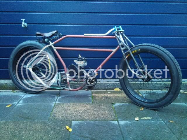

Even with the tyres pumped right up it looks like you've got SFA ground clearance there! I guess you're not going to be out jumping gutters and what not on it though.
It has just shy of 4in with flat tires how much more you want?
Being a road bike i think we are good to go, the pedal comes level with the lower tube also
so pedal strike ain't an issue, not that they will be spinning ;-P
Hyena said:
Does that low clearance make the actuator job easier ? It probably wouldn't have to travel as far ?
Well yes logic would dictate if the bike is lower to the ground the actuator mounted on said bike would have
less to travel, good work there HiGHSiDE .. :mrgreen:

No more progress to report, well, not anything actually made other than a pattern for the pivot
mount aluminum side plates...I did line the old cruiser and new bike up for a side by side comparison thought
it would be interesting to see the differences in length and height...-->
The new ride is alot shorter, will have a lil more nimble handling as a result of reduced wheelbase and
less radical head angle... Still unsure of the weight i can still easiiily lift it i am guessing in the vicinity of ~20kilo
Mate Mick is picking me up to head to Drags tomorrow evening, i will have him pick the bike up and hop
onto the scales before we head out for exact weight as she is now...

hehe so true...was very apparent on a build recently on RatRod Bikes...we had been given all the pics the bicycle looks motorcycle size then the
builder front sup a pic with him on it-->
the bike...very nice custom build IMO...
Hoehas' full worklog of above bike viewable here for those interested...it is a decent effort too well worth a read...
Looks like a fair size bike right...well have a look at the owner taking it for a spin Definitely takes you back
well it did me, you get the feel the bikes are alot bigger with just workshop pics... i will try to get a pic of me near the bike
soon and/OR a mate straddled it with arms out, the reach is spot on, bearing in mind ThudSTaR 8) the seat will be slightly
more forward on this build than the blue cruiser ;) This we need as much weight as possible forward don't we
A.J don't wanna be flipped on his broken behind too much...will practice wheelies on the soft grass at the oval me thinks hehe...

do the depth required in one go, i did two takes for this both about 4mm or so deep...the ali will build up so you cant see the lines,
clear it away periodically, i used a chisel and hammer to tap it and break it off... Best of luck...
KiM

gtadmin said:
AussieJester said:
Yes mate all free hand, clamped the sheet of ali to the bench with two g-clamps and went at it...used the bit in piture
doesn't work the best glogs up immediately so alot of physical effort is needed...Tips...
Use kero to lubricate, won't glog(?) :wink:
Cheers,
GT

AussieJester said:
knoxie said:
8)
Looking good AJ but are you gonna drive this through that geared hub? :? hmm methinks thats a lot more power than it can take buddy? DC shredded a hub gear in no time with a less powerful setup and you have a geared box now dont ya?
Anyways its looking brilliant you can always weld it if it breaks! keep up the hard slog :twisted:
Knoxie
Honestly Knoxie ... ...How you could still not know whats going on after all the pictures and all the posts is beyond me it really is...
Whenever I'm doing anything with metal, aluminum in particular, whether its drilling, cutting, grinding, or sanding, I hit the cutting medium with a shot of WD40 every twenty seconds or so. Drill bits, cutting wheels, grinder stones, sandpaper, jig saw blades....everything lasts indefinitely with this method. I know it all seems like it slings off but if your blade is hot and you give it a shot of WD, the oil cools the blade and pulls some of the lubricant into it. WD probably isn't the best thing but it's worked flawlessly for me so far, doesn't stink too bad and is really cheap. I've noticed that also keeps the blades from sticking, greatly reducing the effort. It doesn't have to be a constant stream, just when you notice whatever you're cutting with is turning aluminum colored, give it a shot. Also, the WD40 apparently doesn't need to be cleaned off before welding. I was cleaning each piece with alcohol and forgot on a few and the welds came out exactly the same in destructive testing.
You're the fab guru and I'm definitely not trying to tell you what to do or anything, I'd just hate to think of one of your projects being delayed because you're spending money on sandpaper and router bits instead of lipo of something. Give it a try. Can't hurt.
Really stoked to see the new cruiser on the road. It looks very sporty and serious all at once.
