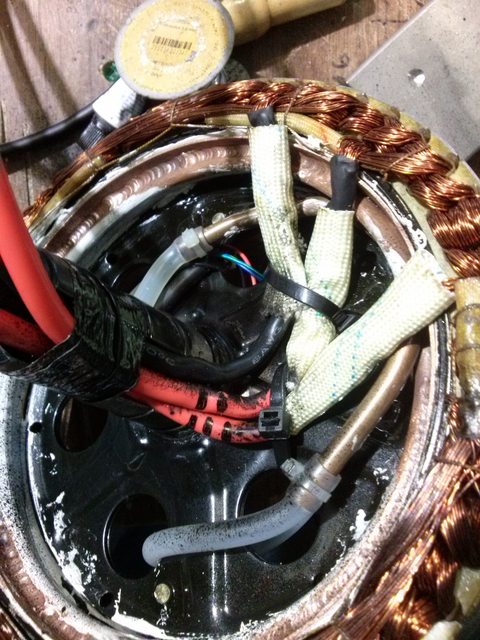

Where you pinpointed the location for heat sinks is where Linukas did put his water cooling loop.

Rather than the cooling loop on that V1 mxus above - we should make the whole stator solid aluminium with a large surface area!
And the V2 mxus was born...
