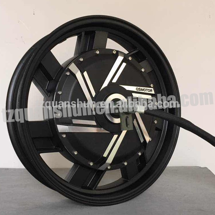

About tests with high power or 1000W of heat:
shouldn't thermal resistance not stay the same between about 200W used for the tests and 1000W?
@John
I am with you on the outer shell parts. I would love to see manufacturers making an effort to allow for more thermal masses on the outside parts.
I keep thinking of my old Suzuki GSX 1100. All them fins really made heat removal easy at speed. Those motors was not really advanced like todays liquid cooled motors. But due to the large outside surface you could ride forever WOT without overheating, accelerate over and over again without any over heat problems.
If covers, or the part between the flanges had an even larger surface area more heat could be removed faster. As you said such a solution would even cater for the off road e-bikers, and it would be interesting to see how a modified large surfaced motor shell would perform in conjunction with Ferro Fluid. But for street riders it seems Ferro Fluid would be all that is needed for hub to stay cool.
@Justin Thx for all the testing you are doing. It is amazing to see real data on cooling, before all cooling threads have been based on peoples experiences or even thesis rather then on cold hard test data, I fell what your are doing here with all the testing is a quantum leap forward for more stable motors, longevity and possible also longevity for high powered motors. Kudos for your hard work Justin. Much obliged.
Good point about a mag rim heat sink. If only we could get some dedicated mag rim hub motors for e-bicycles that look cool and are strong and light (will not make it look like a scooter). Maybe real magnesium.
About the FF and gelling. This is not a concern for 99% of the members on here unless you do a long mountain climb every day and have a huge battery pack. Most member don't have a large enough battery for FF gelling to be a concern. So what if you need new fluid after 5 years or whatever. By then hub motors will by a 1/2 the weight with with the same torque
FF is the great addition for the everyday ebike that goes up and down hills and rides in the rain and dirt (sealed motor). For a race bike liquid cooling or forced air venting is still going to be obviously superior. Potting the windings will help in any case but don't expect huge gains in heat sinking, the big gain with potting is increased insulation life on the magnet wire
