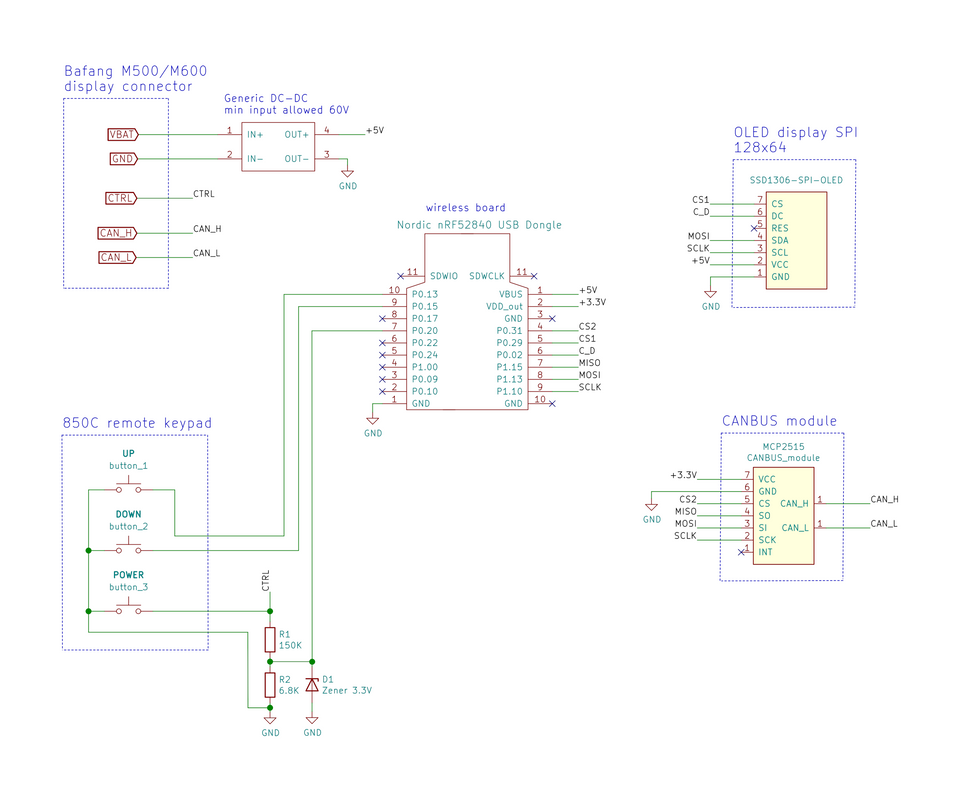

I can confirm that this all worked fine :)
I moved to the Bafang M500 motor, which is very different than TSDZ2, it uses CAN communication instead of UART. The way to turn on/off the motor controller is also different.
Here is the adapted schematic. I am really happy to reuse this display!!

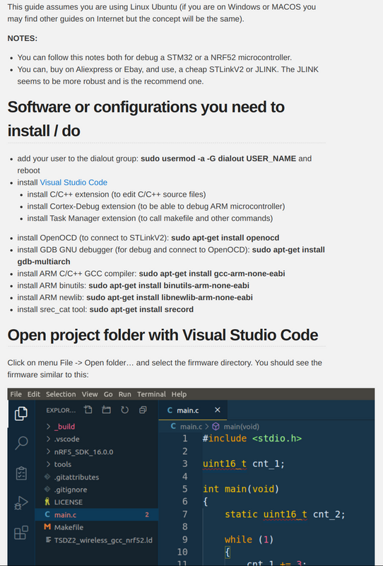

See here the page Configure Code Studio IDE for firmware development, flash and debug: https://opensourceebike.github.io/development/
Thank you for the guide. I tried to follow it on Windows, but got stuck on task reported errors like "Error: the task 'build' neither specifies a command nor a dependsOn property. The task will be ignored."
So I set up an Ubuntu VM, and I have some remarks to improve your guide for people installing this from scratch:
1. 'buld' task complains about missing make command, add 'sudo apt install make'.
2. Running the 'build' task results in a buch of errors like "./ssd1306_driver/SSD1306.c:238:2: error: #error MUST define DISPLAY_I2C or DISPLAY_SPI". I suppose one needs to uncomment #define DEVELOPMENT in main.h, and update the #ifdef DEVELOPMENT clause to match his diaplay.
3. "make[1]: nrfutil: Command not found". I found and installed nrfutil for myself, but I don't think my method is recommendable. An official instruction would be welcome.
I managed to solve these problems and compile the firmware, but I have trouble debugging it. When I start OpenOCD task I get this:

You did very well!! Can you improve the documentation with all the notes (that I clearly understand, but as I installed that tools on already my PC, I did not saw it). For instance, nrfutill I install with pip3 install nrfutil.
Can you improve the documentation and make a pull request? then I will accept that changes.
Your only small issue is that you started the debug for JLink and not for STLinkV2 - on this project I only use JLink!! Grab here on this other project, the configurations for STLinkV2: https://github.com/EBiCS/EBiCS_motor_FOC/blob/main/example/.vscode/tasks.json
You can also add it and submit a pull request.
Yes, the build should be configured to call "make -DDEVELOPMENT"...
