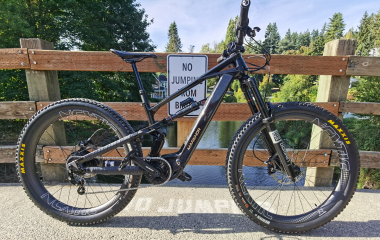

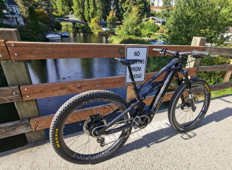

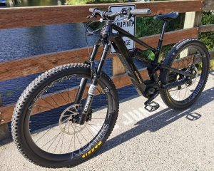

It is almost ready guys! Installed heavy duty steel chainring and heavy duty drivetrain to handle the power.
We did it guys! It works including the torque sensor and everting else! The walk mode works properly too (it looks like the motor needs some initial resistance and to spin the motor at low speed at walk mode, so on the bicycle it works just fine).

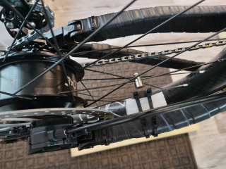

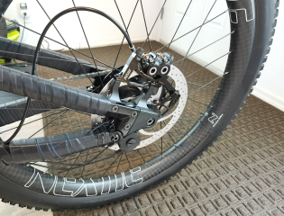

By the way the new Bafang speed sensor needs to be places far from moving metal objects if you don't want to use it as signal source. It picked the brake rotor spokes as signal and the speed reading was too fast so I just zip tied it on the chain stay and put a regular magnet on the rear wheel spoke and it works properly that way. I could leave the sensor at the rear brake rotor but that probably requires changing the firmware to set the proper ratio between the speed sensor signal and the the speed and the VESC application allows only to select the wheel size which is limited only by 26", 27.5" and 29" wheels and you can not trick the program selecting smaller wheel size.
This is basically it guys, the reverse engineering is complete and the controller is tested and it works! I will upload the updated controller cover CAD model which now fits both Dengfu frames and Markhor Kunlun frame.
Now I just need to build new battery to have moar power!

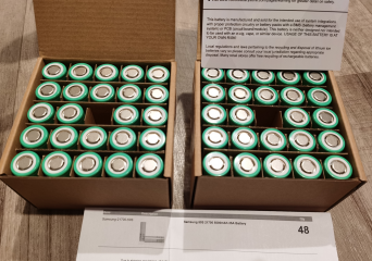

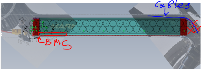

Started mocking up the custom battery for the controller and it looks like 16S3P is the best we can do with this frame. So it is going to be 60V 50A 3000W which is probably good because of this is a standard Luna controller tune.
These are Samsung 50S cells. Each cell is capable 25A continuous. Therefore 3P is going to be 25A × 3 = 75A. The BMS I am going to use limits the current to 60A. The Luna firmware predefined maximum setting is 50A (but I can set any on the controller up to what the BMS is capable of). So the current is going to be limited by the motor controller, it is 50A. 50A × 60V = 3000W.
But the battery cells can safely give even more, 75A in 3P configuration, it just needs appropriate BMS for such current and the settings on the motor controller.

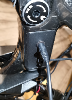

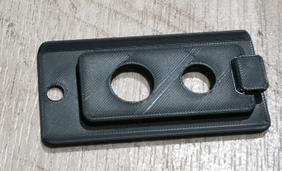

Designed and 3D printed a cover for the charging connector and BMS ON/OFF button for the Kunlun frame for the new battery.
It looks like the Kunlun bicycle uses proprietary charging connector so I ended up placing a common 5.5x2.1mm dc plug most chargers use on the cover
The original cover vs 3D printed
Please keep in mind that the maximum rated continuous current is based on lab tests at a fixed temperature in ambient air.
The limit is determined by the point where the cell barely doesn't explode from thermal runaway.
When you put a bunch of cells together, inside a case, that's a totally different thermal environment and you either need temperature monitoring to cutoff power when it gets too hot, or to derate the heck out of them when in a pack configuration.
Before you hit thermal limits, you get a ton of sag. If you run 20A on this cell, you will get something that looks like lifepo4 nominal voltages, which will dampen your thrill. Here is a discharge graph on that cell at various amperages
( notice that at 30A, the test was cut off early due to heat.. )
Also mind that this large amount of sag also hurts your capacity since >20% of the cell's energy is being turned into heat instead of power once we're near the thermal maximum.
Also once you get down to freezing temperatures, whatever the cell voltage drop is at 'room temperature', it should be 3x-4 that at the freezing point, until the pack heats itself up ( if it can ). If you are in Idaho and ride in the cold, this is a factor to consider.
I'd consider adding another one of those cells in parallel if you are thinking of doing 60A and it's not too late to make the change.
50S is not a very powerful cell, it just happens to accept higher temperatures before exploding and sag more to produce this lofty 25A output ( and only in hyper-ideal conditions ) figure
Seconding- The 50S is honestly pretty mid. Consider the eve 40pl or 50pl, reliance rs50, tenpower 50xg, or various molicel options (especially for low temps) like the p50b, or p45b. All of these would outperform the 50S for CDR and cycle life (the fatal flaw of the 50S)

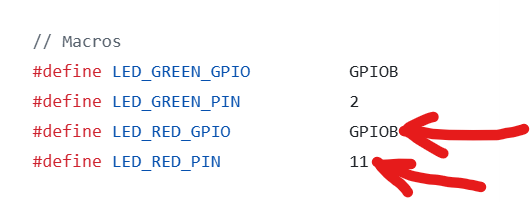

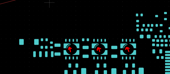

For someone who might still wondering about some mysterious circuits on the PCB. I started digging into the VESC firmware and it looks like one of those circuits is connected to the "LED_RED" function pin PB11 on the MCU while the actual red LED on the PCB is connected to auxiliary pin PC14
It looks like he used that circuits just for the development stage to connect an LED light externally and observe outside the motor externally if 5V is presented (dimmed LED light) and faults events (bright LED light) so it looks like that weird circuit is just a development artifact.
