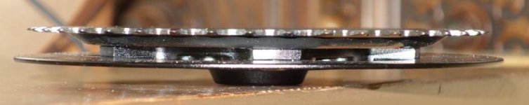

The stock chainring is dished 5mm. Using a flat chainring (the spider is 110mm BCD (bolt circle diameter) so they are common) increases chainline 5mm, so really the stock 42T chainring is the way to go for most cases. 50.7mm is really not bad, so the talk of an inherently terrible chainline is not true when the TDSZ2 fits the bike well. But the TDSZ2 doesn't fit all bikes well (and good guidance about what you need in a frame is not easy to find before you buy, I'm trying to give some of that here). So:

So it is really nice if it fits your 68mm bottom bracket frame. OK, so what can be done about chainline if it too large? (too small is easy, use a non-dished chainring).
1. (easy and cheap, 1mm). Use 10mm inside diameter 1mm thick shim washers McMaster Carr 98089A385 gives dimensions to look for.
2. (harder, not expensive, 3mm) I haven't done this because my chainline is OK, but I am confident it would work. The 42T dished chainring is steel so it has decent thread strength if tapped. The chainring nut is on the inside, If the nut is removed thicker spacers can be used. Tap the existing 10mm holes 7/16-20 UNF. Drill out the spider to 7/16 inch (11.1mm) taking care to keep centered. Use 10mm inside diameter spacers (it looks to me like up to 3mm would work) and assemble directly into the chainring. Grind or shim the bolts to exact length so they don't protrude. If you go metric I think you really want to go fine thread (M12x1.25), even though it is less common. It should be OK but the chainring holes will need to be drilled to 10.9mm before tapping. 7/16-20 is easier if you can get the tap and bolts.
3. (easy, $100, 5mm). Buy the custom 10mm offset 42T chainring made for the TDSZ2. http://www.electrifybike.com/store/p65/42_Tooth_Narrow%2FWide_CNC_7075_T6_Chainring_%2810mm_offset%29_for_TSDZ2.html
