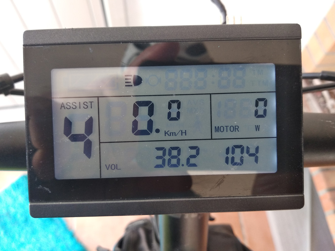

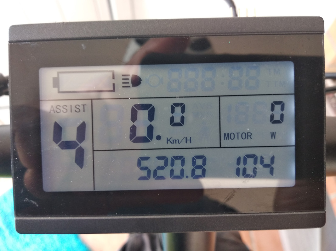

jbalat said:
UPDATE
All good I think. Hex flashed well, display is lit up again but all icons are active and buttons not working. Do I need to flash any option bytes or will it start working when I connect it to the motor ?
You need to flash the firmware on TSDZ2 and connect to LCD3 to get it working.
