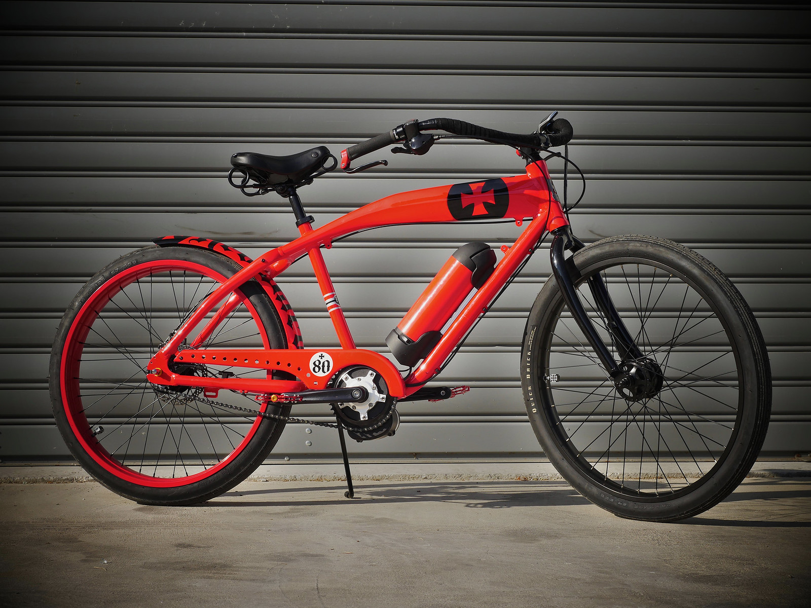

hello every body. here my little contribution. I hope you 'd like it
I personally do not feel comfortable having nazi anything on this forum. Get a new paint job
This is Japanese, Korean, and Chinese tech at work.
I don't see the German link.
But then,,, the German are my second favorite people.
Who's my first,,, you may ask?
Everybody else...... :p
Yep, it a Nazi cross. Please remove the photo from the posting, or the forum moderators/administrators will be involved.
Not nazi stuff I think, seems inspired by the Red Baron, a WW-I tri-plane fighter pilot who won 80 air battles and was awarded an iron cross. He lost his 81st (and died) safely before the nazis came along.
Having said that, few people will enjoy anything german, red-black-and-white, military styled, with gothic letters. Even if it formally pre-dates the nazis.

This Iron Cross imagery is clearly referencing Manfred von Richthofen, the Red Baron. He was dead long before Nazis were a thing. The German military used the Iron Cross back in the 19th century, and still uses it today for some decorations.
Iron Cross images are an established feature of both surfer and biker (as in motorcycles) subcultures, too.
The Germans adopted the form of their Iron Cross from the cross pattée, which is early medieval. The British Victoria Cross and the American Distinguished Flying Cross both use it.
At the moment, the US flag probably has more fascist-specific baggage than the cross pattée.
"yes it is a red baron artwork."
Well, then I stand corrected. Pardon me.
I see 20+ million dead civilians when I see that symbolism [blood and metal]
Ok now that I hear the explanation I see the red barron reference - just be aware that an iron cross with an 8, or 88 usually refers to Hitler "H being the eighth letter of the alphabet". With Neo Nazis in my area I get a bit nervous when I see this stuff, and jump to conclusions. The 0 confused me - now I get it with the Red Barron explanation. Cool history lesson.
That being said - most won't get it, and you might find your bike vandalized or something with that there - sadly you might still want to consider a more overt Red Barron reference. Maybe snoopy as red barron or something:
