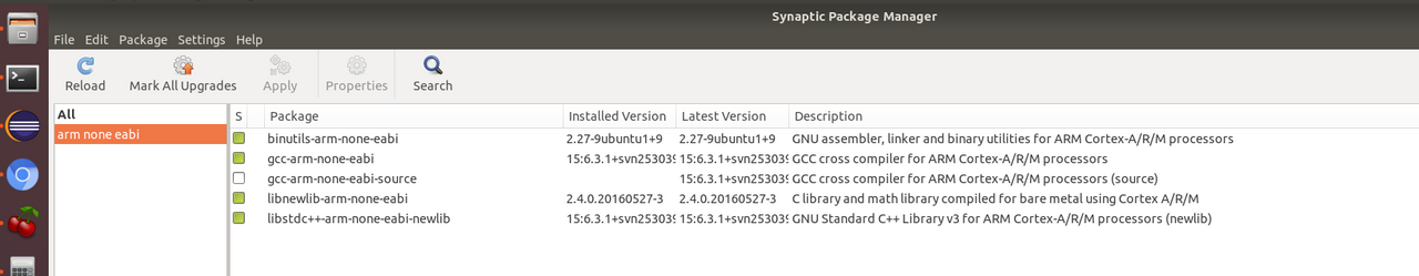

frankly: i really want to make it. i am ambitous. but this is so new for me, including the linux thing.
I have two questions: this gcc arm none-eabi thing: this is a procedure to program bare-metal arm processors? and this cannot be done under windows? there is no such utility for windows?
I have not gotten very far with the command line in linux ,so then i have made virtual machines running graphic versions of ubuntu and debian...i also had found the synaptic package manager....but then...what are my next steps? i don't even know how to make something run ....i will have to dig deeper, i am afraid....i am learning, at least i am trying to...

On my synaptic:
After you have it installed, execute "make" as I told before and here is the output and full build process for me:
On my synaptic:
ok...so i do have the synaptic window like you. but from here i am lost: how do i get the source into the virtual machine, where do i execute make...you see: i am lacking the basic knowledge...you must consider me as someone who has to land a plane but has never flown before.....sorry....so maybe it is very simple and i am just 2 steps away or so, or maybe it is much more complex...i cannot judge it...it looks like i am almost there..but who knows...

To get the sources, is just standard git clone from a github project.
Install "git" on Synaptic and then do on a terminal:
Code:
git clone https://github.com/OpenSource-EBike-firmware/Color_LCD.git
