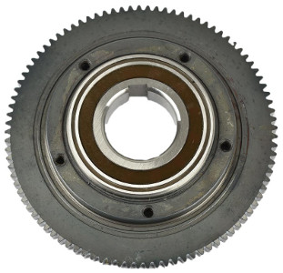

My clutch failed yesterday and I had to search on google about it, luckily, I found the excellent work/videos from jbalat!!
I decided to wrote an entry on TSDZ2 FAQ about the clutch: https://github.com/OpenSource-EBike-firmware/TSDZ2_wiki/wiki/FAQ
Clutch
The sprag clutch is a one way bearing in the tsdz2 ebike torque sensing motor that transfers your pedal torque to the main gear which is attached to the chain ring. After some time, this gear may began slipping/failing. Here is a video from jbalat showing how it happens when sprag clutch is failing: https://www.youtube.com/watch?v=PWlz4xw3pI8
How to repair clutch
1. Buy a new main gear (includes the sprag clutch bearing)
You can buy a new main gear, that includes the sprag clutch bearing, on PSWPower(about 30 euros) or in any other shop.
2. Install the new main gear
See this video from jbalat showing how to remove and install the main gear: https://www.youtube.com/watch?v=u-SY0rGMEMo
Casainho, I kind of understand that the bearing is press fit on the big gear, how did you pull it out from its housing?
Hammer?
Thanks!
Hammer?
Thanks!
That videos are not mine. For my motor, I will just replace the main gear from another motor I have to be used for repair spare parts.
I would prefer to buy a new main wheel for 30 euros if needed.
