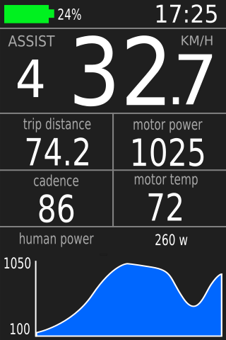

Here is the final design (I hope):
- break and lights symbol (not show on the image) should appear at top, in the middle
- the four fields at the middle can be customized: the data to be shown at each filed can be one of the many variables available, like the ones that are shown on KT-LCD3 odometer field
- the graph field can be customized: the data to be shown can be one of the many variables available, like the ones that are shown on KT-LCD3 odometer field, user will need to define the graph time to be 10, 20 or 30 minutes.

Thanks!! that was the help I though I would need. I will look at that source files and try to play with them as I like your design, HOWEVER, I plan to use like 1/3 the screen, at bottom, for a graph where a variable is shown -- this is something I want much and I think would be really great to have a graph showing like last 30 minutes (LCD 300 pixels width, 300/30 --> 6 seconds each pixel).
The graph must have a label showing the variable name as also scale, and maybe the scale of Y will be automatic while X scale can at start to be like the last 30 minutes.
Sounds great. No idea how hard this is to implement - The large Garmin cycle computers have an interesting setup where you setup multiple "screens" and customise what is displayed in each field
pub
In the configuration you choose for screen 1
FIELD1 = TRIP DISTANCE,
FIELD2 = TRIP TIME
FIELD3 = CADENCE
FIELD4 = ODO
GRAPH = MOTOR TEMPERATURE
Then you configure screen 2 (which you switch to/from using a short press on the power button for example)
FIELD2 = HUMAN POWER
FIELD3 = CADENCE
FIELD4 = MOTOR TEMP
GRAPH = BATTERY CURRENT
This way you let people configure what they want to see on their main screen as well as easy to switch to other combinations.

casainho,
That display and functionality would be AWESOME, I spent today going thru marcoqs changes for the VCLD6 to confirm what was being done but in the end its going to cost about $100US to convert. I also worked on getting everything to fit on my handlebars with the LCD3 in case I wanted to go back to that but this change would suit me better.

Looks fantastic. Appreciate your hard work on this. Best place to buy a new display from for international shipping? (Australia)

Looks great. Can't wait. Actual voltage number would be very useful as an option or instead of % since the graphic also communicates %.
