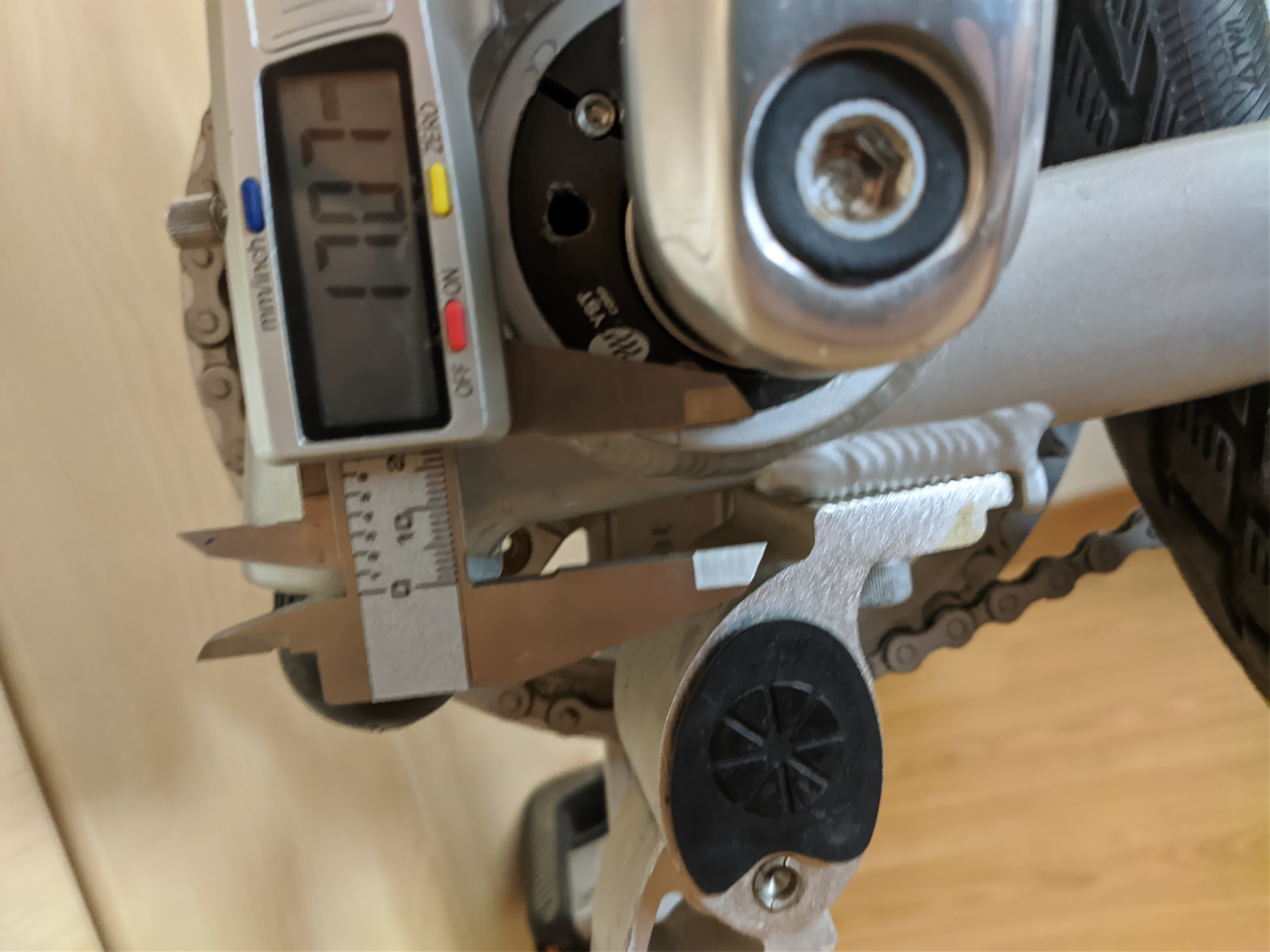

Hello, I am pretty sure that I cannot install the motor as is, is there anyone who has made it work for intergrated frames such as this? I'd like to see it or be advised on how to proceed, should the endeavour be possible. I quite like the open source firmware and the large following this motor has, it'd be great to make it fit on my bicycle, it is a Dahon Ios P7.
Basileios said:
.... it'd be great to make it fit on my bicycle, it is a Dahon Ios P7.....
Because you haven't upload a clear picture of your bottom bracket, I have searched for it,
But it is not easy to find a clear picture and I am not sure which of the two it is.
I don't know which you have, but I imho it is not possible with the first one. For the second one it depends of the dimensions. But it will not be easy and I don't know if the folding system isn't blocked.
Imho it is easier to add a hub motor.
Elinx said:
Thanks for the response, sadly it is the first type with the seat tube in front of the pedals. Would you have any hub motor suggestion?
Basileios said:
.... Would you have any hub motor suggestion?
I have no experience with hub motors, but it depends of you technical skills.
The easiest way is to buy a complete frontwheel, of the same size you have now, with inserted hub motor.
Otherwise you must insert spokes and motor yourself inside the rim.
If you go for a rear hub motor, then it depends which gearing you have, because I think it needs more modifiing with gears and chain.
There are special hub motors for small folding bikes. For the best you search for that.
Maybe you find more info in the building or motor forum.
