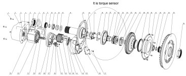

Any suggestions on diagnosing a drive-side creaking noise on my TSDZ2? The noise happens only when I'm pedalling and only on the drive side. It doesn't happen in walk assist.
I've tried reseating the motor, replacing the pedals, reinstalling the crank arms and none of that helped. Other than the creaking noise the bike works fine. Do you think it's a bad bearing? or the torque sensor? It's got a good amount of mileage and 3 years of use.

A possible guess is that the big steel gear just under the drive side motor cover is grinding the motor case. It might have developed axial play due to the helical teeth used. There was a long discussion about this matter in the forum. You don't get this noise in walk assist since the torque is too low to axially move the gear, unlike when you are in pedal assist.
And you can try narrow the problem to the motor by pedaling with the motor off and see whether this noise persists.

Thanks for the suggestion - the noise occurs when pedaling with the motor off and on, same regardless. Do I need to replace the whole motor unit you think?
I took the cover off and it doesn't appear to be rubbing on the outer cover at least. And the bearings appear to be in good shape...

Well I dissassembled the whole thing and it all appeared in good shape. The only unusual wear I saw was on the drive side of the axle (as indicated by the arrow below), so I cleaned and greased that and the problem appears solved for now. Really appreciate all the suggestions!
If you haven't already you can add a bearing to the drive side to support the spindle better - that might help long term creak - and also reduce any wobble. Basically replace the rubber seal in the middle of the spider with a 6902 bearing. See this post - there are others but I can't find them. New "TSDZ2 Torque Sensor Central Motor"
